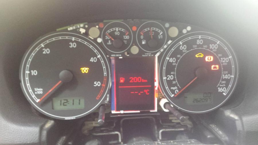

Am pus de proba ceasurile noi pe masina sa vad daca functioneaza. Totul e ok, insa dupa ce pun contactul dupa 15 sec palpaie becul la bujii si imi mai apare imobilizator activat. Am verificat cu diagnoza sa vad ce erori au aparut :
Pe CAN Gateway : 01336 - Data Bus for Comfort System (49-00 - No Communications) si
                               00778 - Steering Angle Sensor (G85) (49-00 - No Communications)
Instruments : 00779 - Outside Air Temp Sensor (G17)
                                   30-10 - Open or Short to Plus - Intermittent
                                   29-10 - Open or Short to Plus - Intermittent
                     01177 - Engine Control Unit
                                  65-10 - Unauthorizel - Intermittent
Engine : 17978 - Engine Start Blocked by Immobilizer
                           P1570 - 35-00 -
              18062 - Please check DTC Memory of Instrument Cluster
                            P1654 - 35-00 -
