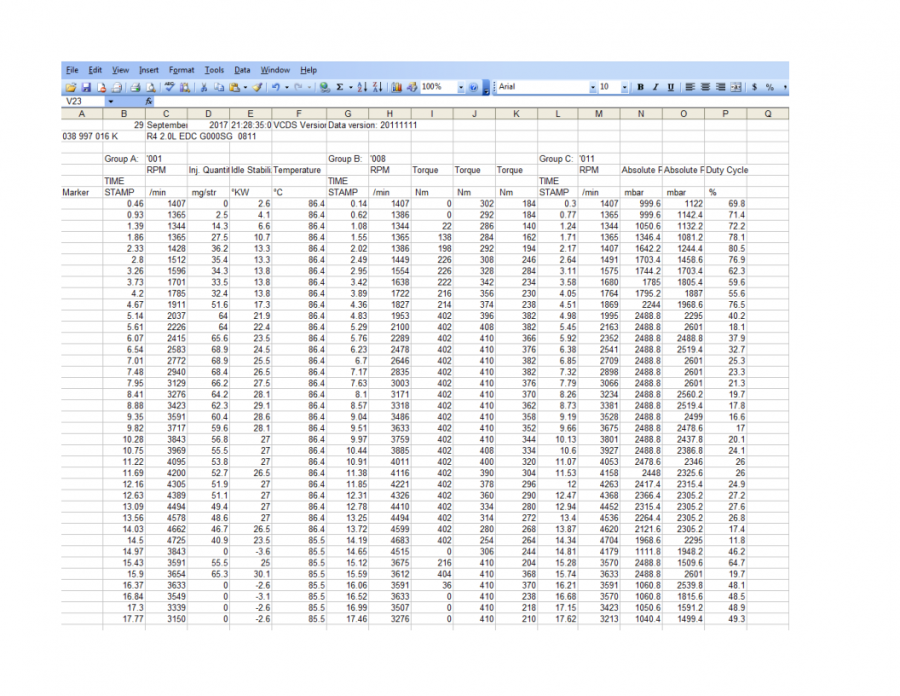

Buna seara domnilor..revin dupa o lunga pauza ..cu o problema din pacate...de ceva vreme se pare ca masina ia limp mode....cel mai des in treapta 4 si 5 undeva intre 2800-300rpm..
Nu am eroare stocata pentru ca cel mai probabil am DTC off in urma resoftarii...si inca o chestie interesanta..de ceva timp se aude turbo cum fluiera chiar daca e la relanti,accelerez sau opresc motorul si motorul se pare ca vibreaza mai tare, cel putin eu simt o diferenta in interior unde se simt vibratii mult mai puternice decat inainte..de curand am schimbat supapa N75 desi nu era nevoie(am schimbat-o preventiv).
atasez un log..ma poate ajuta cineva in interpretarea lui va rog?
va multumesc anticipat
Logul se face pe canalele 3/10/11 pedala apasata 100% de la 1700rpm pana pe la 4000rpm in treptele 3 si 4...
Pe langa asta faci si BS 003 si BS011 si le postezi pe topicul dedicat
Succes!
Dar inainte sa faci logul, rezolvi vacumul, ca nu este ok de cand ai schimbat N75. Altfel faci logul degeaba.

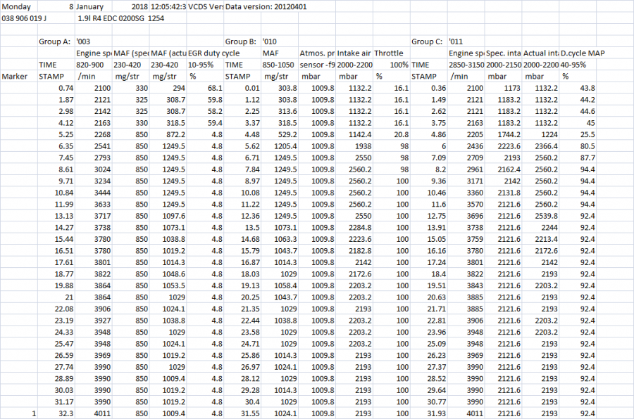

Buna seara. Am un vw  Sharan 1.9 AUY La o scanare am gasit
Saturday,30,December,2017,12:47:05:32264
VCDS Version: Release 11.11.3
Data version: 20120401
                Address 01: Engine       Labels: 038-906-019-AJM.lbl
Control Module Part Number: 038 906 019 J
  Component and/or Version:  1,9l R4 EDC 0200SG  1254
           Software Coding: 00002
            Work Shop Code: WSC 00020
                      VCID: 1E39C0A19AACF49
1 Fault Found:
17965 - Charge Pressure Control
            P1557 - 35-10 - Positive Deviation - Intermittent
Readiness: 0 0 X X X
 In data de 08/01 2017 am plecat catre Sinaia si am facut un test in mers.
                Address 01: Engine  (038 906 019 J)
11:44:58 Group 003: EGR (Exhaust Gases Recycling)
  882 /min  Engine speed 820-900
  250.0 mg/str  MAF (specified) 230-420
  264.6 mg/str  MAF (actual) 230-420
  84.5 %  EGR duty cycle 10-95%
11:44:58 Group 010: Air system (3rd gear - 3000rpm - full load)
  274.4 mg/str  MAF 850-1050
  1009.8 mbar  Atmos. pressure sensor -f96-
  1030.2 mbar  Intake air press. 2000-2200
  0.0 %  Throttle 100%
11:44:58 Group 011: Charge pressure control (3rd gear - 3000rpm - full load)
  882 /min  Engine speed 2850-3150
  1009.8 mbar  Spec. intake press. 2000-2150
  1030.2 mbar  Actual intake press. 2000-2200
  19.9 %  D.cycle MAP 40-95%
 Cum pare testul?
Turbina necesita verificare/curatare/reconditionare .
Log-urile la turbina se fac in mers .
Modificat de EEXCALADE
EEXCALADE valorile sunt citite in mers.
image.thumb.png.3a5fc8945563874add0e0f9c7ab49e89.pngMonday8January201812:05:42:32264VCDS Version: Release 11.11.3Data version: 20120401
038 906 019 J 1.9l R4 EDC 0200SG  1254
Group A:'003Group B:'010Group C:'011
Engine speedMAF (specified)MAF (actual)EGR duty cycleMAFAtmos. pressureIntake air press.ThrottleEngine speedSpec. intake press.Actual intake press.D.cycle MAP
TIME820-900230-420230-42010-95%TIME850-1050sensor -f96-2000-2200100%TIME2850-31502000-21502000-220040-95%
MarkerSTAMP /min mg/str mg/str %STAMP mg/str mbar mbar %STAMP /min mbar mbar %
0.74210033029468.10.01303.81009.81132.216.10.36210011731132.243.8
1.872121325308.759.81.12303.81009.81132.216.11.4921211183.21132.244.2
2.982142325308.758.22.25313.61009.81132.216.12.6221211183.21132.244.6
4.122163330318.559.43.37318.51009.81132.216.13.7521631183.21132.245
5.252268850872.24.84.48529.21009.81142.420.84.8622051744.2122425.5
6.3525418501249.54.85.621205.41009.8193898624362223.62366.480.5
7.4527938501249.54.86.711249.51009.82550987.09270921932560.287.7
8.6130248501249.54.87.841249.51009.82560.2988.229612162.42560.294.4
9.7132348501249.54.88.971249.51009.82560.21009.36317121422560.294.4
10.8434448501249.54.810.081249.51009.82560.210010.4633602131.82560.294.4
11.9936338501249.54.811.221249.51009.82560.210011.635702121.62560.294.4
13.1337178501097.64.812.361249.51009.8255010012.7536962121.62539.892.4
14.2737388501073.14.813.51073.11009.82284.810013.9137382121.6224492.4
15.4437808501038.84.814.681063.31009.82223.610015.0537592121.62213.492.4
16.5137808501019.24.815.791043.71009.82182.810016.1637802121.62172.692.4
17.6138018501014.34.816.871014.31009.8214210017.2438012121.6214292.4
18.7738228501048.64.818.0310291009.82172.610018.438222121.6219392.4
19.8838648501053.54.819.131058.41009.82203.210019.5138432121.62203.292.4
21386485010294.820.251043.71009.82203.210020.6338852121.6219392.4
22.0839068501024.14.821.3510291009.8219310021.7138852121.6219392.4
23.1939278501038.84.822.441038.81009.82203.210022.8139062121.62203.292.4
24.33394885010294.823.5810291009.82203.210023.9639482121.62203.292.4
25.4739488501024.14.824.7110291009.82203.210025.0939482121.6219392.4
26.5939698501019.24.825.861014.31009.8219310026.2339692121.6219392.4
27.74399085010294.826.971024.11009.8219310027.3739902121.6219392.4
28.8939908501009.44.828.1210291009.8219310028.5239902121.6219392.4
30.0339908501019.24.829.281014.31009.8219310029.6439902121.6219392.4
31.1739908501019.24.830.410291009.8219310030.7739902121.6219392.4
132.340118501009.44.831.551024.11009.8219310031.9340112121.6219392.4
Turbina necesita verificare/curatare/reconditionare/inlocuire
