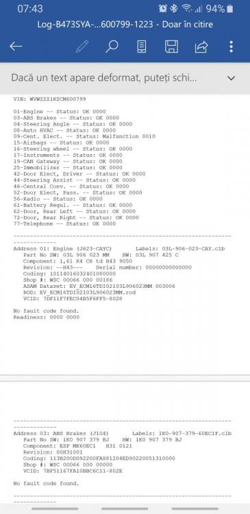

Nu am mai scos mufa la senzorul de temperatura,am pus un vcds si am.urmatoarele valori.
Motor rece ,pornit de cca 2 min
Injector 1     -1,1889 mg/stroke
Injector 2     0,8494 mg/stroke
Injector 3     -1,7456 mg/stroke
Injector 4      2,6223 mg/stroke
Motor cald,apa la 90 grade
Injector 1      -1,1677 mg/stroke
Injector 2      0,3093 mg/stroke
Injector 3      -0,0456 mg/stroke
Injector 4      0,8758 mg/stroke.

9050, e cea de fabrica.
Ultima inainte de dieselgate e 9971. Am si eu pe CAYC.
