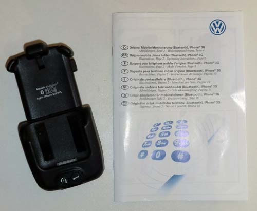

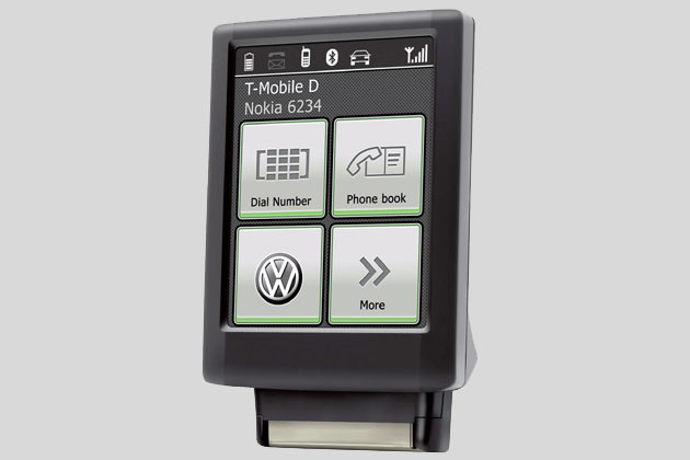

Cam asta iti trebuie
Bafta
For vehicles with a factory-fitted mobile telephone preparation
Volkswagen Genuine Bluetooth pairing-adapter
The Bluetooth pairing-adapter connects your mobile
phone to the hands-free system of your car via Bluetooth.
Simply insert into the existing cradle of the factory fitted
mobile telephone preparation, connect the mobile phone
via Bluetooth hands-free profile and in the future, leave
your mobile phone in your pocket while you're driving.
Art. no. 3C0 051 435 PA
Sau
Volkswagen Genuine Bluetooth Touch-Adapter
When using the Bluetooth Touch-Adapter, you can operate
your mobile phone with comfort via the high resolution
touchscreen. Simply insert into the existing cradle of the
factory fitted mobile telephone preparation, activate the
Bluetooth hands-free profile in your mobile phone and
connect your mobile phone with the adapter. Once it has
been set up, you can simply leave your mobile phone in
Art. no. 3C0 051 435 TA

Baseplate-ul il ai, dar adaptorul universal il ai? (SG2 nu are adaptor specific)
for reference

salut! am cumparat si eu un 3C0 051 435 TA . dar fata de suportul pt 6310i se aude jalnic de prost:( sunt dezamagit. ma bucur ca nu l-am luat nou ca sa dau 200€ .
eu am adaptorul de 1 an si se aude f bine sa nu aiba ceva al tau .... de unde l-ai luat ?

iuly1209 - din belgia l-am cumparat .acum m-am obisnuit cu el.:) dar tot mai bine se aude suportul pt 6310i .
la mine merge la fel nu e nici o diferenta ....... fa-i un software update vezi pe google - vw touch adapter si te trimite la pagina lor .
