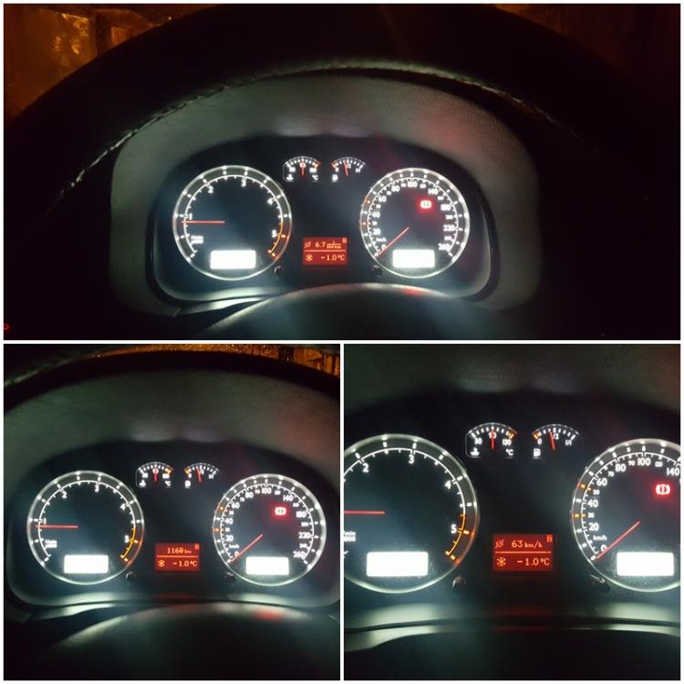

M-a uimit consumul de data asta, cu 4 persoane, portbagaj ful si nemenajata unde am putut dat fiind conditiile meteo...

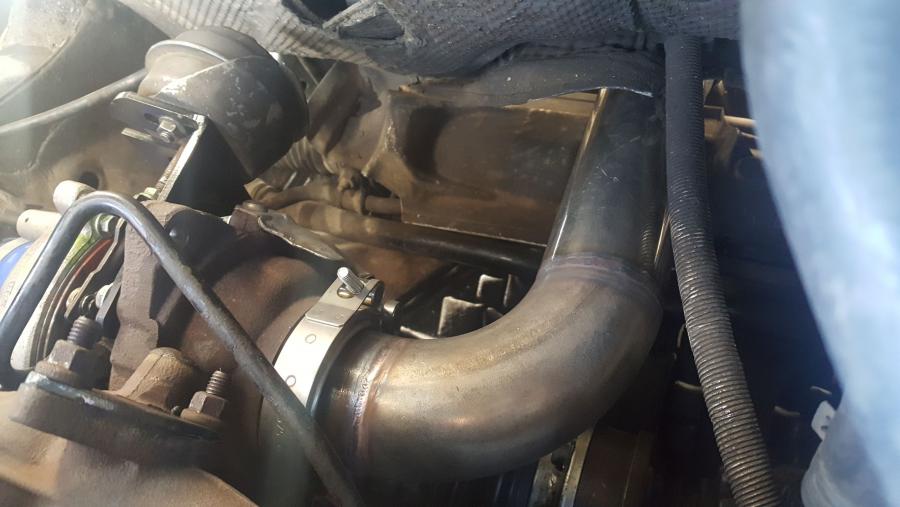

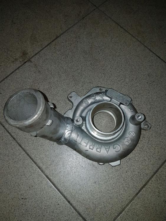

Las doua poze primite de la cel care mi-a montat turbina, eu nu am mai facut...
IMG-20170320-WA0001.thumb.jpg.aa34b2a221c6d82465eaaf0ce7dd03b9.jpgIMG-20170320-WA0005.thumb.jpg.2e7d94e253c728fe43e8e53b8b4296ba.jpg

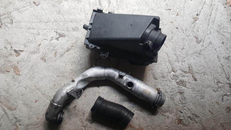

Sa inspire bine golfuletu zic :))20170330_105826.thumb.jpg.37a8977dce23cb733888d3dc7212241d.jpg

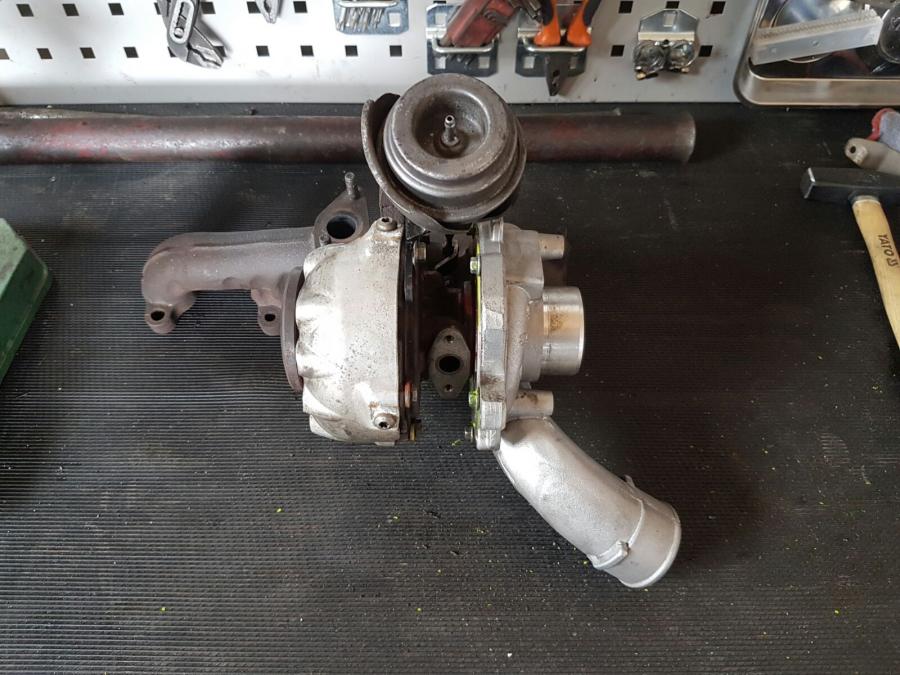

Am strecurat telefonu pt o poza cu turbina pusa 20170323_124216.thumb.jpg.edb46fa75964fa4049eb1bec7f446213.jpg
Vine si ala dupa ce pun tot :)
