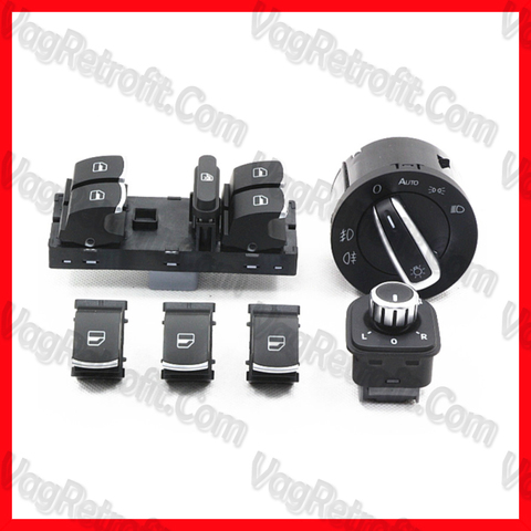

Butoane cromate. Preț:350 lei.post-128380-0-80165100-1398715875_thumb.
