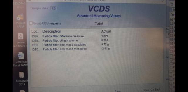

In Advanced Measuring Values cauti in lista si bifezi  differential pressure sensor
Am inteles. Multumesc. Revin maine cu info.
Am revenit cu captura...
Multumesc frumos. Si cu soot mass mesured de 3.61 care nu se mai modifica? Sa nu mi fac griji?
Este  -3.61,da-i pace

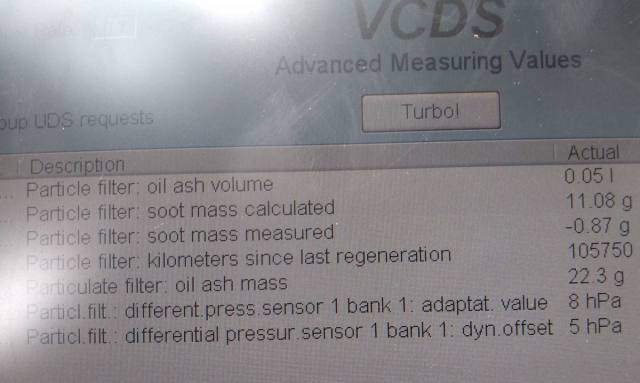

Motor DFGA, am gasit mai multe coduri:
IDE07744 Particulate filter: differential sensor pressure 1: row 1: gross value
IDE07745 Particulate filter: differential sensor pressure 1: row 1: adaptation value
IDE07747 Particulate filter: differential sensor pressure 1: row 1: offset
IDE07748 Particulate filter: differential sensor pressure 1: row 1: dyn. Offset
IDE11896   Particle filter: differential press. sens.1 bank 1: raw value 1
Care anume cod trebuie citit pentru valoarea presiunii diferentiale?
Modificat de EEXCALADE
