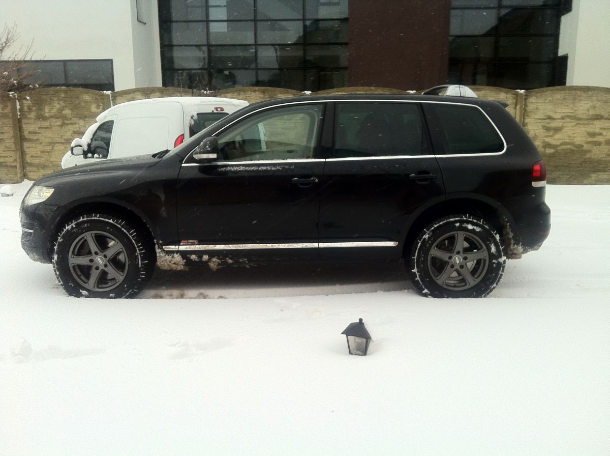

New pics and video.
post-15613-0-80491200-1327612229_thumb.j
