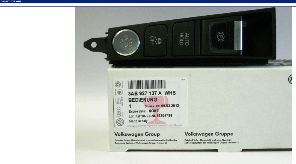

At the very minimum.... you would need the following:
3AB 713 203 A TVJ - This is the new style Gear Shift Cover on the 2013 model
Or if you have the twin clutch based transmission this one
3AB 713 203 E TVJ
Then the bottom trim piece:
3AA 863 324 NV1 - Silver / Aluminum Trim piece - No 4 Motion logo
or
3AA 863 324 B NV1 - Silver / Aluminum Trim Piece - with 4 Motion Logo

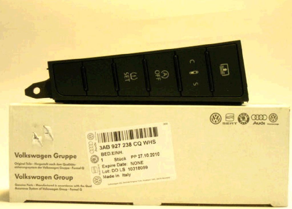

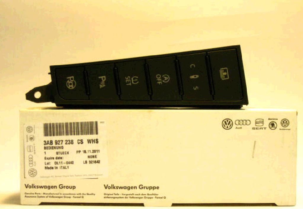

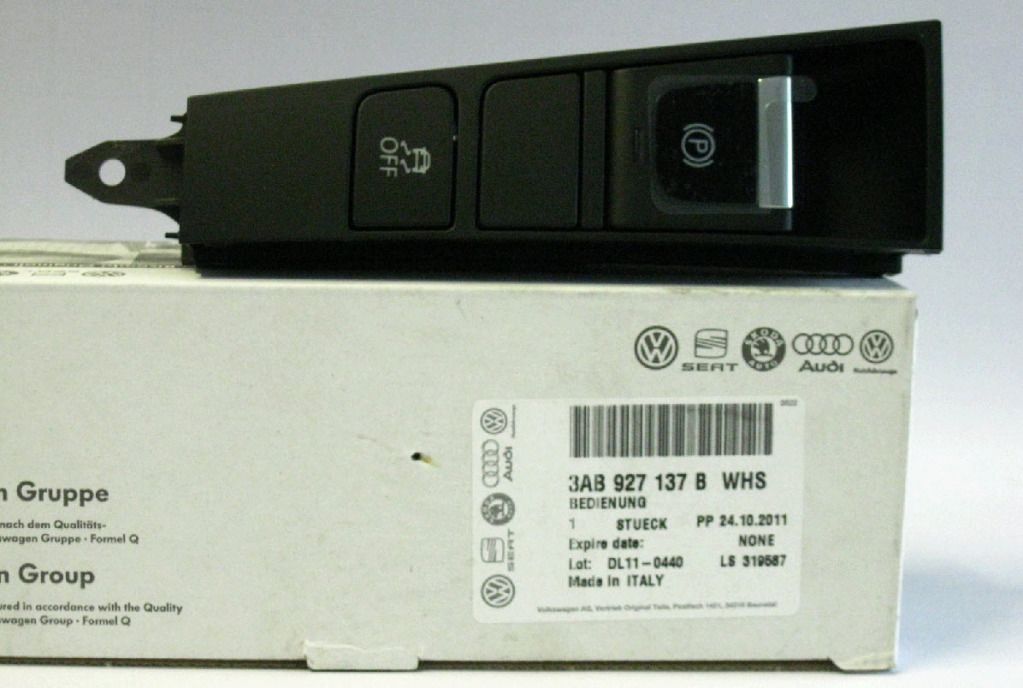

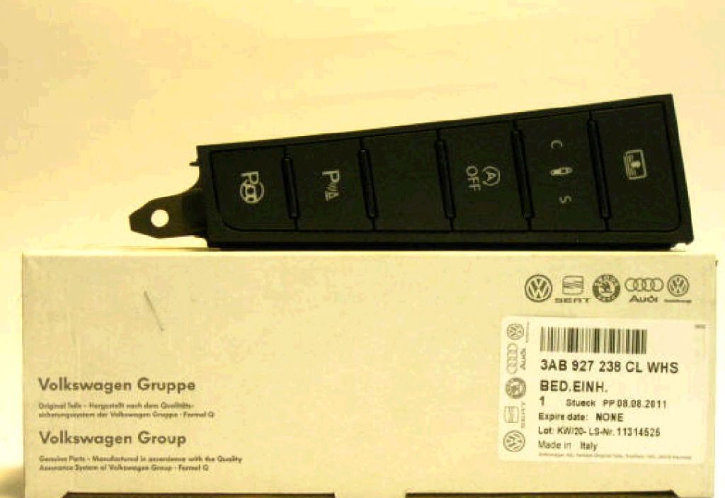

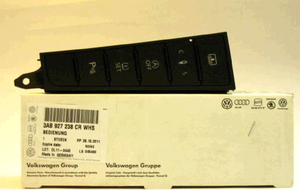

Then there's the various options for the buttons. Part #s are on the pictures below:
The options for the "Driver Side Buttons" are as follows:
EPB and ESP only
EPB' date=' ESP, and Auto-Hold
[img']http://i97.photobucket.com/albums/l235/usaf-lt-g/2013%20Shifter%20Button%20Options/EPB-ESP-AutoHold.jpg
EPB, ESP, ZAT, Auto-Hold
Passenger Side Button Options (there's a million combinations of these button in different positions, but you get the picture i'm sure):
Rollo, C/S, SET, Eco Start/Stop
Rollo, C/S, SET, Eco Start/Stop, Park Assist
Rollo, C/S, SET, PDC, Eco Start/Stop, Park Assist
Roll, C/S, Eco Start/Stop, Park Assist System, Park Assist

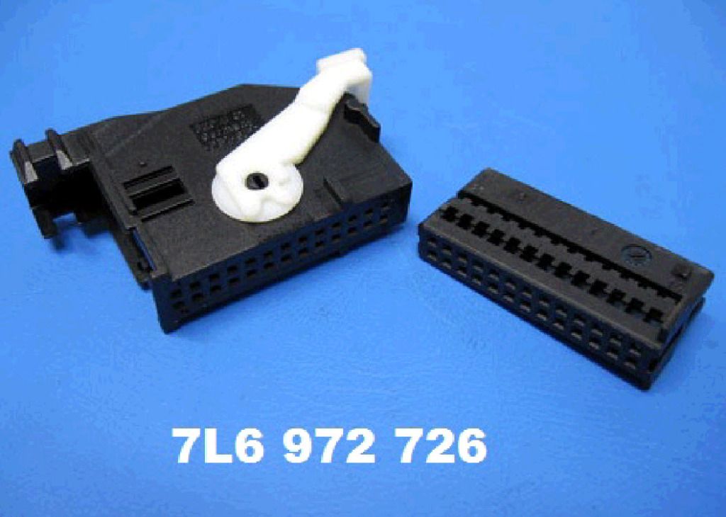

Then there's the connectors for the Start/Stop system if you adapt that:
26-pin Connector
and the pins can be connected via this repair wire:
The other buttons utilize a 6 pin connector. Not sure what's on your model or not... you'd have to verify.
Deci mi-ar trebui unul care sa aiba butoanele astea: Eco Start/Stop, Park Assist System, Park Assist.
26-pin Connector ala ce face, ca nu mi-e clar?

Conectorul cu 26 de pini are legatura cu:
Daca nu te intereseaza cred ca poate fi ignorat.
