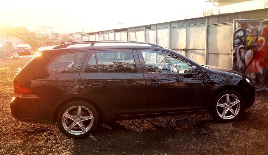

17" 7.5J ET45 cu anvelope 225x45 R17. Directie un pic mai greoaie, dar restul ok.
Modificat de golfaholic
Exact aceleasi specificatii si la mine, mi se pare ca vin perfect fata de aripi.
Sunt mai in afara cu circa 1,77 cm fata de rotile de fabrica.
https://www.willtheyfit.com/index.php?width=205&aspect=55&diameter=16&wheelwidth=6.5&offset=50&width2=225&aspect2=45&wheel_size=17&wheel_width=7-5&offset2=45
