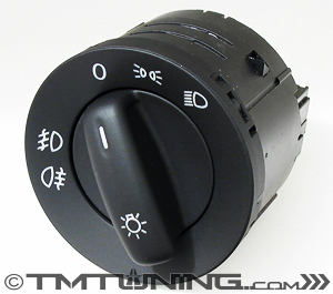

Cele noi se prezinta sub forma urmatoare cu tot cu preturi :
VW OEM Golf 5/Jetta 5/Passat 3C (B6)/EOS/Touran/Caddy Euro headlight switch US $ 75.00
VW OEM Golf 5/Jetta 5/Passat 3C (B6)/EOS/Touran/Caddy Euro headlight switch with AUTOMATIC driving light, "coming home" and "home leaving" function US $ 75.00
Pentru cele cromate pretul e mai mic si iti recomand acest model tinand cont ca arata mai bine
VW OEM CC/MK 5,6/Scirocco MK3 euro AUTO headlight switch US $ 69.00
VW OEM CC/MK 5,6/Scirocco MK3 euro NON-AUTO headlight switch US $ 69.00
VW OEM CC/MK 5,6/Scirocco MK3 euro AUTO headlight switch for cars with foglights US $ 69.00
VW OEM CC/MK 5,6/Scirocco MK3 euro NON-AUTO headlight switch for cars with foglights US $ 69.00

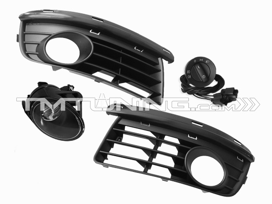

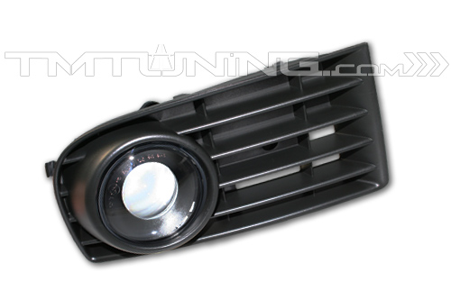

sau kitul complet OEM cu proiectoare comutator si instalatia aferenta
VW OEM Golf 5 GTI projector foglight kit with open GTI vents US $ 249.00 / set order no.: G5-L-110-GTI
VW OEM Golf 5 GT projector foglight kit with GT vents US $ 233.00 / set order no.: G5-L-110-GT
VW OEM Jetta 5 projector foglight kit, with bumper side vents with extended upper brow (without chrome trims) US $ 239.00 / set VW OEM Jetta 5 projector foglight kit, with bumper side vents (without chrome trims) US $ 239.00 / set
Golf 5/Jetta 5/Passat 3C/Eos/Touran projector foglight harness set US $ 49.00 / set
Si pozele cu ele ca sa-ti faci o idee. Numai bine tuturor !
