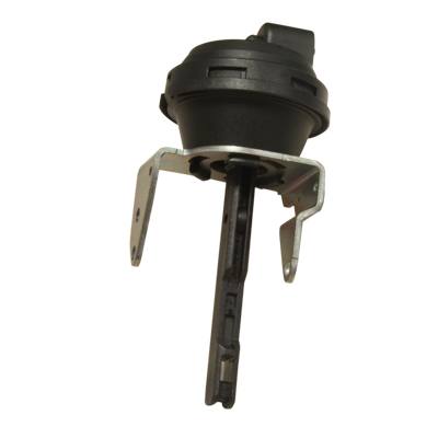

Am o problema la o Skoda Octavia 2 1.6 FSI. Se aprinde check engine si da urmatoare eroare:
008213 - Intake Manifold Flap Position Sensor (Bank 1)
P2015 - 008 - Implausible Signal - MIL ON
Stie cineva vreo rezolvare?
Verifica furtun vacuum,capsula clapete galerie admisie. Posibil furtun fisurat si pierde vacuumul sau capsula sparta.
