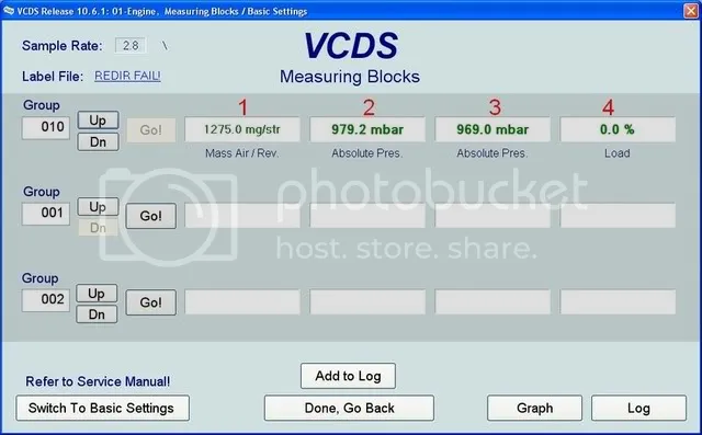

Revin cu update la problema de mai sus. Am gasit o procedura de testare a MAF care arata cam asa:
With the engine not running, but the ignition switched on:
Connect up Vagcom/VCDS
Select the engine control module [01]
Select measured blocks [08]
Select Group 10
You should now be confronted with a screen similar to that below:
The 4 sets of figures are as follows:
1 = The amount of air being drawn into the engine. This will either be 0 or 1275 depending on the version of Vagcom/VCDS.
2 = Atmospheric pressure in millibars
3 = Intake manifold pressure in millibars
4 = This is your throttle pedal position, so should read 0 with your foot off the pedal, and 100 with your foot flat to the floor.
The values shown in 2 and 3 should be nice and stable. Value 3 should be the same as 2 (tolerance ± 30 mbar).
If everything looks good, then chances are your intake pressure sender is healthy.
If value 3 is fluctuating badly, then you need to double check the connections to the intake pressure sender, or replace it.
As a further test, you can do the following:
Start the engine
Select Group 10
With the engine idling, disconnect the intake manifold pressure sender connector and watch value 3. It must fall briefly to about 400 mbar and then rise to the same value as value 2. If it doesn’t, check the connections to the intake pressure sender, or replace it.

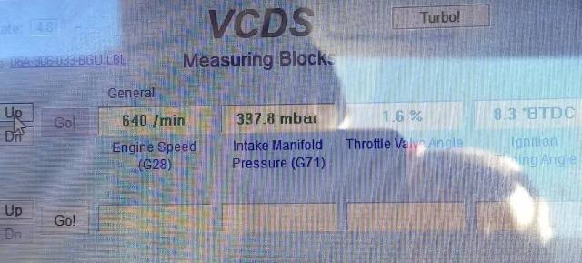

Am facut procedura nr. 2 si la scoaterea mufei de la G71 motorul se opreste. Problema este ca la mine valoarea indicata de MAF (ianinte de a deconecta mufa evident) este foarte scazuta, in jurul valorii de 400mbar. Deci am un senzor defect? Atasez poza:
Modificat de florynbadescu
Tu faci o mare confuzie aici, motorul tau nu are senzor MAF ( debitmetru de aer) are MAP (senzor care masoara presiunea absoluta din galeria de admisie), cel mai simplu test pt un senzor map se face c-am asa: cu motorul oprit presiunea indicata de senzor ar trebui sa fie aproape de valoarea presiunii atmosferice, cu motorul pornit presiunea indicata trebuie sa fie in jurul valori de 400 mbar.

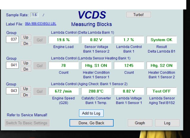

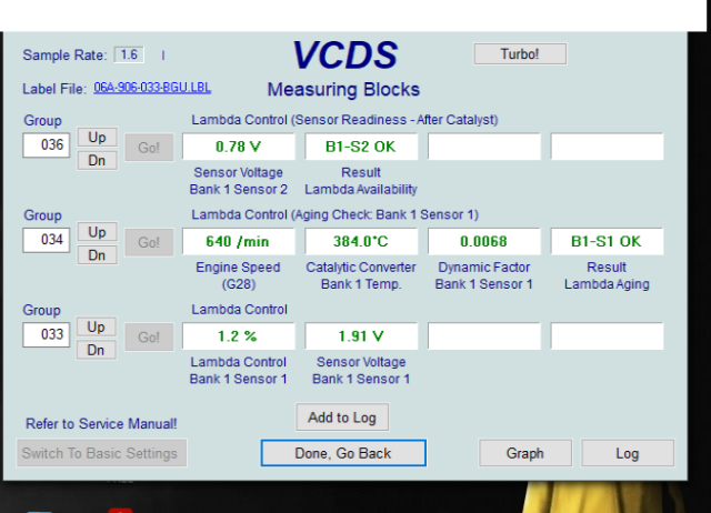

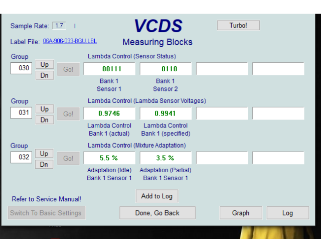

Am facut ce mi-a recomandat xmisterx. Cu motorul oprit MAP indica 989.4mbar si la relanti 397.8mbar. Valoarea la relanti ar fi ok (in jur de 400) dar cea cu motorul oprit nu-i cam mica (ar trebui sa fie 1013)? Atasez poze cu valorile din grupurile 30,31,32,33,34,36,37,41 unde apare ca sondele lambda ar fi ok. Catalizatorul a iesit ca e ok in grup 46.  Am facut log in mers pentru a vedea si alte valori. Postez aici poate stie cineva ce are masina.
Gr303132.thumb.png.3089204bf5a7efd15597fe2b23bec552.pngGr374143.thumb.png.0987b7d94de4b11d60091e4b66d380a8.pngGr333436.thumb.png.ba1c158dd176cb2e039737ff9819d403.png

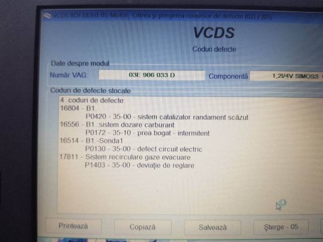

Ibiza 1.2 12 valve( 3 cilindrii) AZQ, nu mai porneste, acestea sunt singurele erori, tehnicienii mi-au spus ca e distributia, dar nu au verificat-o cu cale, se poate verifica ceva din vcds referitor la sincronizare ? Cand se da la automat se aude ca si cum n-ar avea bujiile puse, dar bujiile sunt umezite in ultimul hal, le-am curatat, la fel, umede, de ce se inneaca? Sa fie blocat returul ? Presiune in rampa am 2.8 bar.
Modificat de opleistul23
In topicul asta trebuia să postezi aici este pentru benzinare.
Daca ai scânteie la bujii, după descrierea ta, este foarte plauzibil sa fie distribuția sărită (când învârte foarte ușor, ca  și cum ar avea bujiile scoase înseamnă că supapele nu se mai închid la momentul potrivit și scăpa compresia, de aici și umezirea bujiilor). Asta trebuie verificat prima dată. Fizic. Cu vcds nu cred că se poate.
Asta are distributia pe lant, eu nu cred ca este decalata, plus ca ar fi trebuit sa apara eroare de sincronizare intre ax si arbore cotit, eu cred ca sunt probleme cu aprinderea, o problema de presiune in rampa , ar putea fi defect regulatorul, Presiunea de 2.8 bari unde a fost masurata, pe tur sau retur? Eu zic ca inainte de a verifica distributia sa faci un test de compresie daca iese prost verifica distributia.
