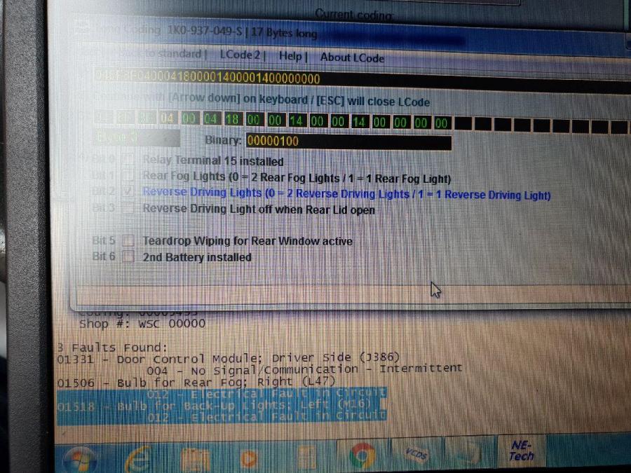

La Golf am de asemenea cateva erori:
Address 08: Auto HVAC        Labels: 1K0-907-044.lbl
   Part No: 100 907 044 GX
   Component: ClimatronicPQ35 066 0606
   Shop #: WSC 00000 000 00000
   VCID: 68D5A6795B68FA9
2 Faults Found:
01809 - Actuating Motor for Temperature Flap; Left (V158)
            000 -  -
01274 - Air Flow Flap Positioning Motor (V71)
            000 -  -  - Intermittent
Address 09: Cent. Elect.        Labels: 3C0-937-049-23-M.lbl
   Part No SW: 1K0 937 049 S    HW: 1K0 937 049 S*
   Component: Bordnetz-SG 1.0 H30 0704
   Revision: 00030000    Serial number: 00000000848037
   Coding: 008F8F0600041800001400001400000000
   VCID: 3F875D256E669D1
   Subsystem 1 - Part No: 1K1 955 119 B  Labels: 1KX-955-119.CLB
   Component: Wischer VW350  012  0401
   Coding: 00065493
   Shop #: WSC 00000
3 Faults Found:
01331 - Door Control Module; Driver Side (J386)
            004 - No Signal/Communication - Intermittent
01506 - Bulb for Rear Fog; Right (L47)
            012 - Electrical Fault in Circuit
01518 - Bulb for Back-Up Lights; Left (M16)
Address 42: Door Elect, Driver        Labels: 1K0-959-701-MIN1.lbl
   Part No: 1K0 959 701 E
   Component: Tuersteuergeraet 09 0147
   Coding: 0000051
   Shop #: WSC 00028 028 00001
   VCID: 30650E19A338729
2 Faults Found:
01552 - Motor for Central Locking; Drivers Door (V56); Lock
00131 - Outside Door Handle Illumination/mirror Light Driver Side
Address 46: Central Conv.        Labels: 1K0-959-433-MIN.clb
   Part No: 1K0 959 433 BL
   Component: 01 KSG              0301
   Coding: 98C802087F2D8404084F01E010
   VCID: 7BFFE9353AFE411
   Component:   Sounder n.mounted
   Component:       NGS n.mounted
   Component:      IRUE n.mounted
1 Fault Found:
Address 52: Door Elect, Pass.        Labels: 1K0-959-702-MIN1.lbl
   Part No: 1K0 959 702 E
   Coding: 0000051
   VCID: 31630B1DA8327B1
1 Fault Found:
00132 - Outside Door Handle Illumination/mirror Light Passenger Side
Nu am manere exterioare iluminate, nici lumini sub oglinda, de unde scot optiunile astea sa nu mai imi dea erori? De asemenea eroare cu becul de la stopul de ceata a aparut azi, cand am inlocuit CANBUS-ul de la E cat aveam eu la P. Modulul P a fost montat pe o Skoda Octavia Variant cu volan pe dreapta, am schimbat cu Golf 5 Hatchback, cu volan pe stanga, am sters eroarea, dar a reaparut. Am debifat Foglights si tot a ramas eroarea, banuiesc ca trebuie bifat si schimbat ceva la bitul 2 (inainte de debifare arata 06, dupa debifare arata 04). Scuze pt calitatea fotografiei.
Multumesc anticipat pentru raspunsuri.
