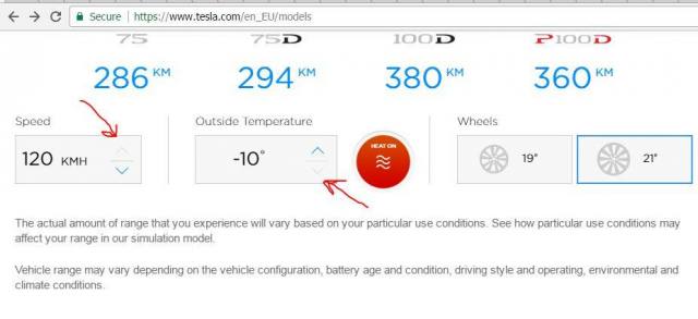

Si la Tesla, selectand jantele mari, autonomia scade chiar in configurator. Ar mai fi si multele filme pe youtube cu cei care spun ca jantele mari sint o problema pt confort (inclusiv EngineeringExplained are un video cand a spart roata intr-o gropita mica prin care trec apoi sute de masini fara probleme cat sta el acolo si asteapta masina de depanare)

Nu mai reusesc sa gasesc la Tesla configuratorul, inainte arata clar cum scade in functie de ce jante alegeai. Am gasit doar o poza mai veche.

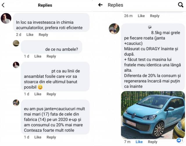

12 hours ago, mandelu said:
vad insa ca daca vrei sa extinzi cu adevarat autonomia, sa ii pui ca optiune pompa de caldura.
Printre primele comentarii, tradus cu google Translate:
"1200 € ... bring max. 60km more range - calculated on 330 or 430km and only at -20 degrees, at 0 degrees it is much less. And a lot comes from the savings at the beginning. Those who can preheat at home save little. How often is it -20 ° or negative at all when you drive? Far too rarely ... and 60km range I can recharge in 6 minutes on the 100 kw charger on the days, so it gets tight, the 60km x 15kwh / hkm = 9 kWh maximum. And in terms of costs, 9 kWh save at 25 cents / kWh at home at € 2.25 ... To recoup the € 1200 investment, I need 1200 / 2.25 = 533 battery charges, so I would always have heat pump weather. 533 battery charges x 330 km = 176,000 km but 176,000 km in cold weather of -10 degrees, it takes here forever to come together. clearly overpriced, which in our e-Golf cost € 800 and brought almost nothing. You can definitely forget that if you can preheat the electricity at home, because then the advantage of the pump drops to a maximum of 1-2 kWh per hour of course. You only need it at high altitudes in Bavaria's Black Forest and low mountain ranges and where it blows constantly. Wouldn't we buy again in Southwest Lower Saxony. The effect is minimal"
Omul se pare ca detine 2 eGolfuri, unu cu pompa de caldura si unul fara:
" In the first e-golf - we have 2019 and 2020s - the heat pump does not bring 10% of range anymore and not one day a year. It was a total bad investment in the e-golf - but it only cost € 800. For a long time in the year it brings nothing, then something and finally a little more, but because of the 5% range, it is not worth it, because if you want to run your battery down to 5% range, you will also sometimes get stuck ..."
Mi-a placut si acest comentariu:
"VW only creates 30% more range itself, based on situations that unfortunately do not occur in reality. Abbreviated, the kidding us again. Enough heat pumps have been tested by other manufacturers, the result: 5 to 8% more range. Oh one more thing, I don't know of any other manufacturer that advertises up to 30% more range, reminds me a little of the "cleanest diesel in the world". Well, as long as Michel believes in it, everything is fine. In this sense, stay healthy"
Edited by detinator
