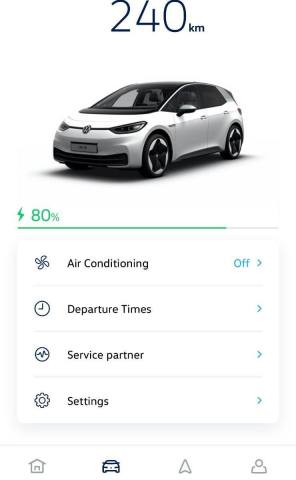

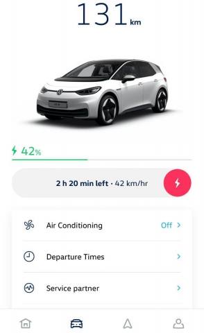

La fel de important e si ca in 2 ore si 20 min de stat la birou, incarci de la 42% la 80%, adaugand 110 km range. Varianta Pure trage cu 7.4kwh/ora AC.
1828436739_ACCharge1.thumb.jpg.74e894d9fa2ccdeb5b2fe4f6dc4f4b22.jpg963916342_ACcharge2.thumb.jpg.88bc843c19df7da461e28638ca66a638.jpg1351085880_ACCharge3.thumb.jpg.807a2758137df57be91e93101ce486e6.jpg
Modificat de cj.Paul
7.4 kWh/ora = 7.4 kW  (ora apare si la numarator si la numitor si deci se simplifica).

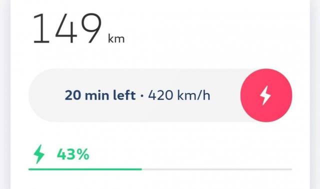

mi a placut la IONITY in austria. pacat ca nu pe toate statiile poti vedea puterea de incarcare in timp real (kwh). doar in ungaria am gasit una, dar care incarca sub asteptari, pe la vreo 36-38kwh.
incarca fara probleme cu 100kW:
