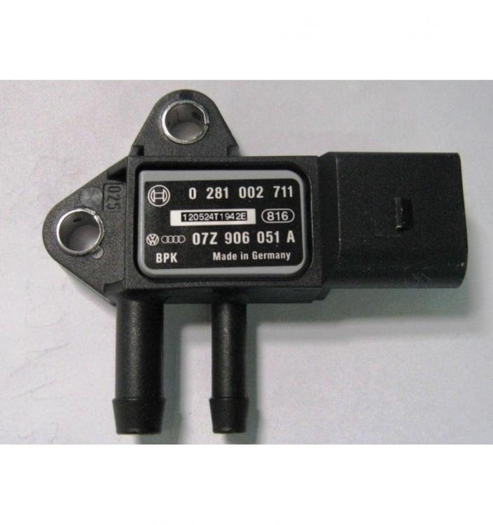

REzolvarea este simpla, schimba senzorul de presiune diferentiala cu unul NOU, OEM.
sau nou, Bosch - mai ieftin si este cel care vine in cutia...OEM

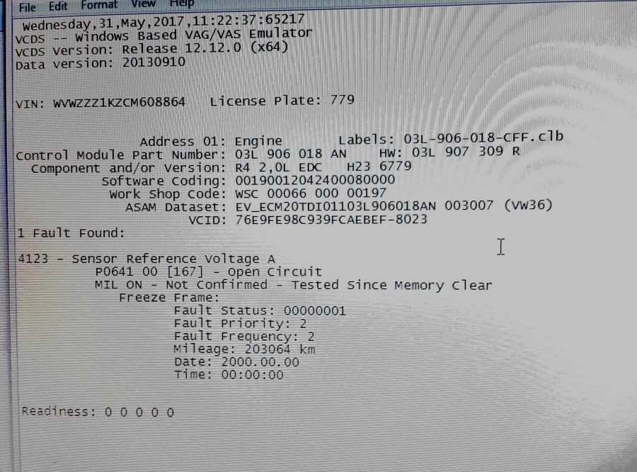

Salut, la Vw Jetta 2011 2.0tdi motor CFFB 230000km am urmatoarele erori:
               Address 01: Engine       Labels: 03L-906-018-CFF.clb
Control Module Part Number: 03L 906 018     HW: 03L 907 309 R
  Component and/or Version: R4 2.0l TDI   H23 9978
           Software Coding: 00190012042400080000
            Work Shop Code: WSC 34515 001 1048576
              ASAM Dataset: EV_ECM20TDI01103L906018 003014 (VW36)
                      VCID: E7D725451E76751
3 Faults Found:
5158 - Diesel Particulate Filter; Differential Pressure Sensor
          P2456 00 [096] - Intermittent
          Intermittent - Not Confirmed - Tested Since Memory Clear
             Freeze Frame:
                    Fault Status: 01100000
                    Fault Priority: 0
                    Fault Frequency: 20
                    Reset counter: 32
                    Mileage: 5305 km
                    Date: 2000.00.00
                    Time: 00:00:00
5290 - Throttle Actuator Control Circuit
          P2100 00 [032] - Open
             Freeze Frame:
                    Fault Status: 00000001
                    Fault Priority: 2
                    Fault Frequency: 2
                    Mileage: 149836 km
                    Date: 2068.14.17
                    Time: 11:11:21
5305 - Throttle Position Sensor (G69)
          P0123 00 [032] - Signal too High
             Freeze Frame:
                    Fault Priority: 2
                    Fault Frequency: 2
                    Mileage: 149836 km
                    Date: 2068.14.17
                    Time: 11:11:21
Readiness: 0 0 0 0 0

Inlocuieste  senzorul de presiune diferentiala,pune oe sau bosch
