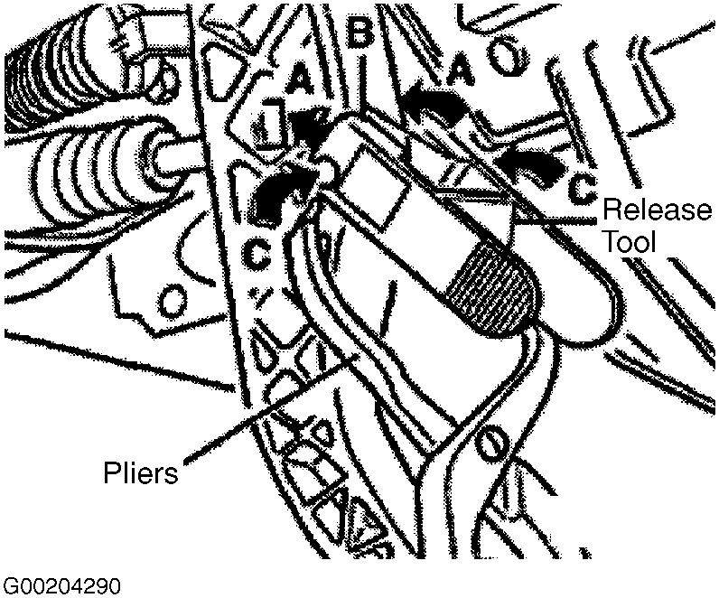

De la Bentley/Haynes citire : :vaidecapulmeu:
"Clutch is a single-disc type, using a diaphragm spring to engage pressure plate.
Clutch is hydraulically controlled by master cylinder, slave cylinder, release lever and pre-lubricated release bearing.
Clutch master cylinder is supplied fluid from brake master cylinder fluid reservoir."
Revin si spun iarasi : Orice reglaj al acelei tije AFECTEAZA cursa dintre disc si placa de presiune si deci afecteaza intregul sistem de ambreiaj.
