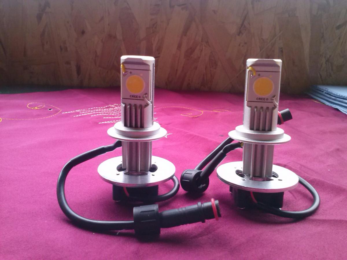

H7 55W LED Headlight Kit 1800 lumens with Integrated Cree 1512 LED Chip 5000k. in seara asta le.am montat pe faza lunga.
