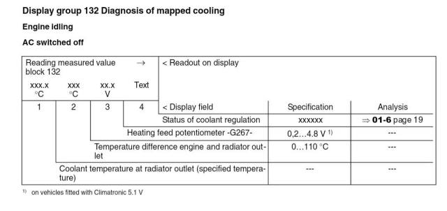

Am cautat si pun acum print screen
Print scren-uri din vcds

Compresor shut off  0.0  cu clima pe auto
Compresor shut off  6.0 cu clima pe economic
  On 01.04.2015 at 8:56, allyn87 a scris:
 asta am gaist pe net
Breakdown of compressor shut-off conditions
0 Compressor on (no shut-off condition detected.)
1 Compressor off (pressure in refrigerant circuit was or is too high.)
Compressoroff (basic setting not performed or not performed without error.)
Compressor off (pressure in refrigerant circuit is too low.)
4 Compressor off (engine nor running or has been running for less than 2 sec.)
Compressor off (engine speed is below 300/ min.)
6 Compressor off (compressor switched off by ECON118°C.)
