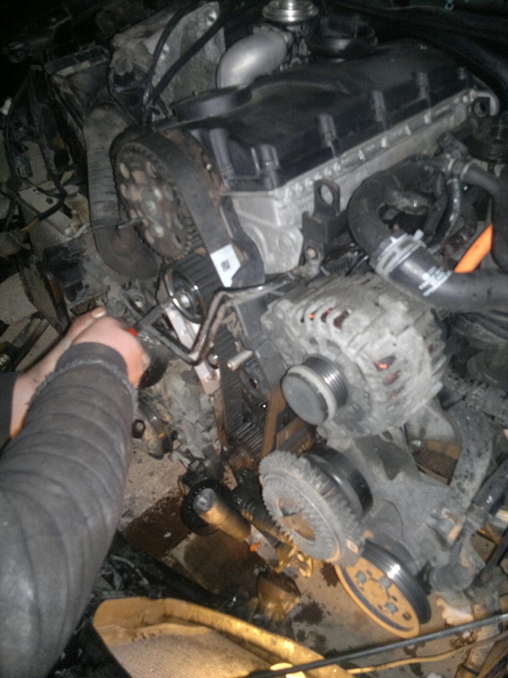

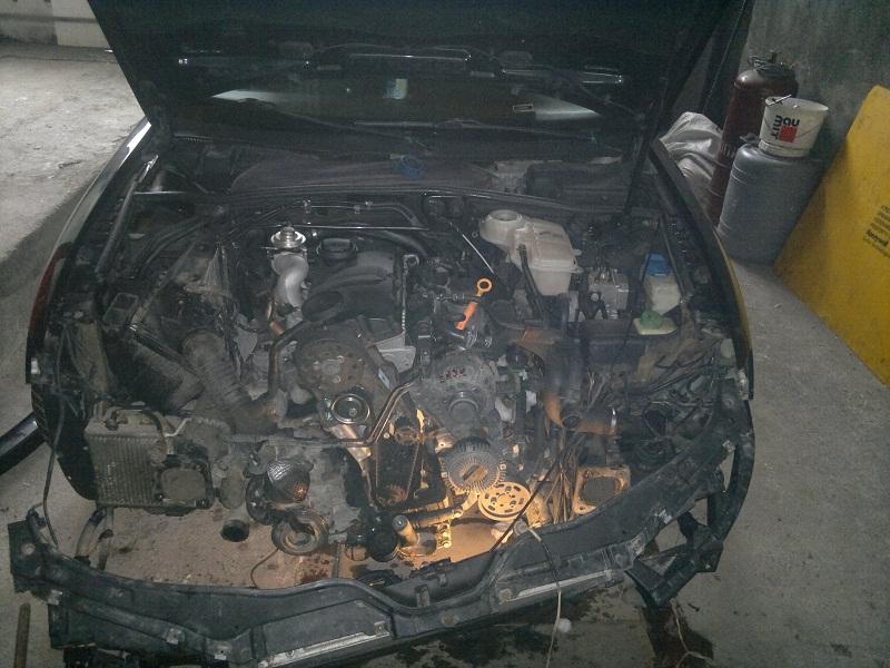

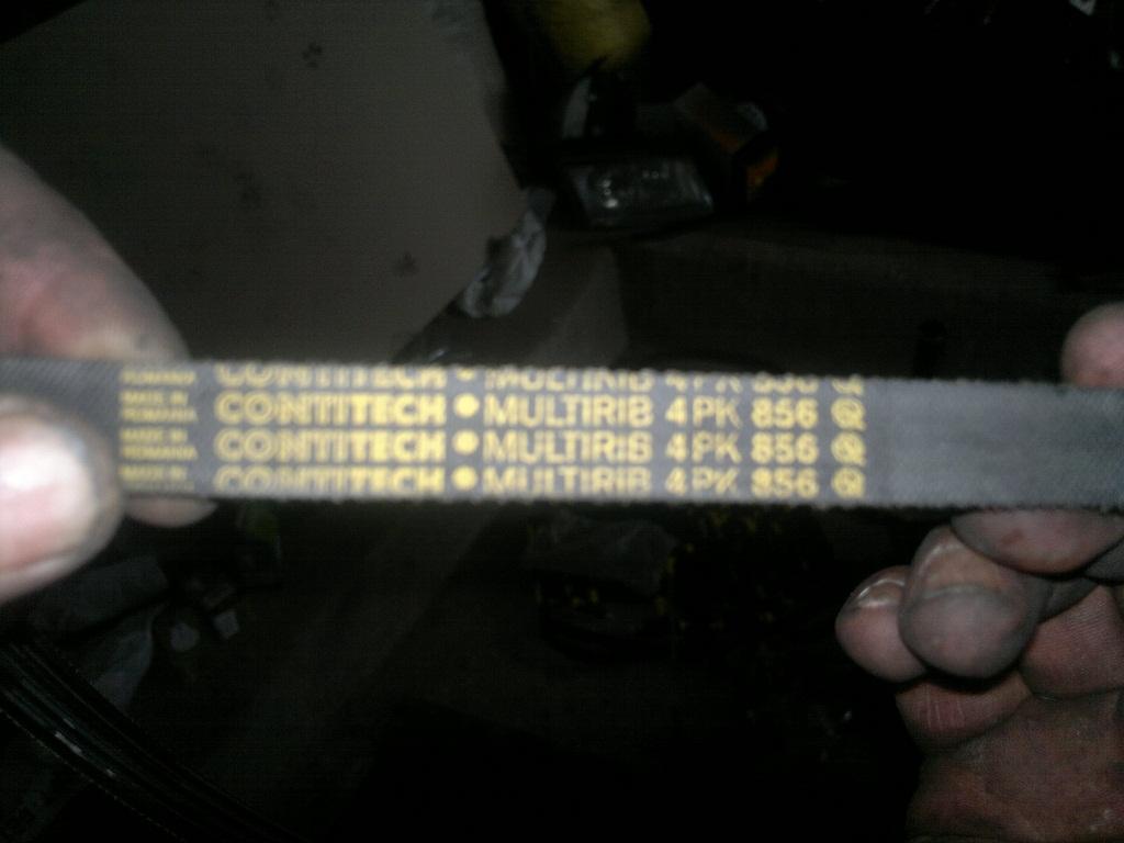

post-98123-0-33849100-1364065983_thumb.j
post-98123-0-01285900-1364066045_thumb.j
post-98123-0-58481700-1364066132_thumb.j
post-98123-0-07624200-1364066191_thumb.j
post-98123-0-08864500-1364066568_thumb.j
