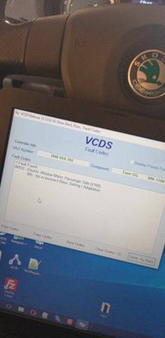

Pana una alta, o solutie ar fi ca dupa ce "il apuca" nebadaiile sa-l recalibrati inapoi prin urmatoare procedura postata de colegul turbocip intr-un alt topic :)
Riddler
ai incercat asta:
00933 - Electric Window Motor; Passenger Side (V148): No or Incorrect Basic Setting / Adaptation
Possible Symptoms
Window Automatic Run not working
Pinch Protection limited
Possible Causes
Automatic Run & Pinch Protection not adapted
Possible Solutions
Adapt Automatic Run & Pinch Protection (see Special Notes)
Special Notes
Pinch Protection Adaptation
Make sure the window in question is completely closed.
Use the driver door window buttons to operate the window(s).
Roll down the window and keep holding the button down for 2 additional seconds after the window is already fully opened.
Roll up the window and keep holding the button up for 2 additional seconds after the window is already fully closed.
Now test the window automatic
Asta e o solutie temporara, care merge o perioada (pana acum, eu unu am 1 saptamana de cand l-am recalibrat) dar cred ca problema se afla tot in softul calculatorului de usa :D
Modificat de Riddler
tare : deci din pozitia initiala de inchis se deschide si se mentine apasat pe deschis inca 2+ secunde , apoi se inchide si tot asa se tine pe inchis inca 2+ secunde .
Toata treaba se face de la usa soferului ?
In acest moment ar trebui sa se recalibreze , corect ?
Eu de la comenzile de pe usa soferului o fac (deh, comoditate :coffee_lol:), si merge :)
Cand il "apuca" iar o sa incerc sa-l recalibrez de pe usa cu pricina.
Oricum toata chestia asta dureaza maxim 2 minute si o poti face si cand stai la semafor ;)
