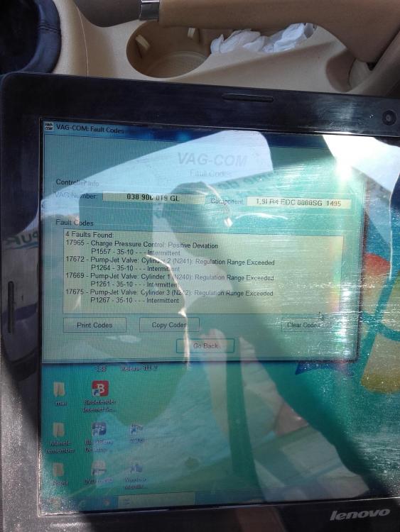

Buna ziua si bine v-am gasit  dragi posesori de VW ,  sunt de curand proprietarul unuu vw jetta 2007 1.9tdi bxe  101000km , masina am luat-o la 98000km  (km reali) in august , cu aceasi problema , fum albastru la pornire  (un puf  2-3 sec la pornire dupa care dispare), cum mecanici buni  in Targoviste nu am gasit  o sa inecrc sa ii dau eu de capat , am cumparat interfata vagcom , am facut o diagnoza   la care a iesit bujia  de pe cilindrul 1  arsa , le-am schimbat pe toate  , acelasi fum albastru  in continuare , vreau sa mentionez  ca , cu cat sta masina mai mult nepornita (2-3 zile) cu atat mai mult este fumul alba stru la pornire ,  postez si valorile injectoarelor la cald si la rece:
  masura cu motorul cald
 Address 01: Engine  (03G 906 021 PM)
19:13:12 Group 013: Idle Stabilization (Injection Quantity Deviation)
  -0.05 mg/str  Injection Quantity Deviation Cyl. 1
  0.24 mg/str  Injection Quantity Deviation Cyl. 2
  -0.21 mg/str  Injection Quantity Deviation Cyl. 3
  0.00 mg/str  Injection Quantity Deviation Cyl. 4
19:13:12 Group 005: Start Conditions (last Engine Start)
  840 /min  Engine Speed (G28)
  14.0 mg/str  Start Injection Quantity
  48.0  Start Synchronisation
  83.7°C  Coolant Temperature (G62)
pornire la rece:
07:14:57 Group 004: Pump-Jet Valves
  903 /min  Engine Speed (G28)
  5.9 °BTDC  Injection Start (specified)
  6.6°KW  Injection Duration (specified)
  -0.5°KW  Torsion Value
07:14:57 Group 013: Idle Stabilization (Injection Quantity Deviation)
  0.82 mg/str  Injection Quantity Deviation Cyl. 2
  -0.28 mg/str  Injection Quantity Deviation Cyl. 3
  -0.45 mg/str  Injection Quantity Deviation Cyl. 4
07:14:57 Group 007: Temperatures
  12.6°C  Fuel Temperature (G81)
  7.2°C  Intake Air Temperature (G72)
  13.5°C  Coolant Temperature (G62)
Ceva pareri ?

jetta - verifica jocul in ax al turbinei, fa un test de compresie (sa iti notezi valorile) - asteptam feedback cu datele solicitate si vedem mai departe, cum te putem ajuta....
Din cate stiu asta e Euro4 fara DPF.
In acest caz, e cam normal sa scoata fum 2 secunde la pornire.
In cel mai rau caz sunt simeringuri la supape. Dar nici asta nu prea cred...
cam noua sa scoata fum albastru la pornire... nu este nici foarte frig. Bujiile sunt bune, deci nu trebuie sa scoata fum albastru la pornire.
Salut , da , o sa fac o programare la Skoda (  service-ul se pare ca e cel mai bun pe motoare gama vag in  Targoviste) , si o sa va tin la curent cu datele.
La reprezentanta vw in Targoviste am fost si au zis ca am avansul prea mic -0.5   si ca trebuie sa fie pe plus ,  oricum le am spus sa il lase asa momentan.
Eu decand am luat-o  am facut cam 3000 km  , am verficat uleiul atunci era pe max ,    acum la km astia este o diferenta de 1mm pe joja.
Ce pot sa spun cu siguranta km masinii sunt reali .
Garniturile ( o-ringurile ) de la injectoare ar putea cauza problema asta?
