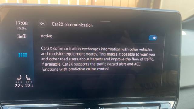

Seara am citit pe meinid.com, un forum german, ca ar putea fi ceva probleme cu car2x, care nu se mai putea activa, motivele fiind:
1. the certificate was deleted during flashing/parameterization and the workshop did not notice the error memory entry. If the certificate error memory entry comes, commissioning must still be carried out. But that's no reason to worry - the certificate should be uploaded online within 2-3 days and car2x will work again.
2nd it is not a certificate error but the J666 (8107) was "killed" by the flash routine. CPU error in memory with message ecu defective. In this case, the ECU can no longer be addressed via DOIP. Therefore, car2x no longer works - not even after 2-3 days ----> change the ECU.
That was the reason why 2.4 was withdrawn 2 months ago, since the J666 was dismantled, so it should now appear rather seldom.
the support for the possible eventualities and problems that can occur with the 2.4 update has meanwhile shot action codes with which most problem cases can be solved.
Ce era mai rau  nu sa confirmat, azi dimineata functionand din nou.

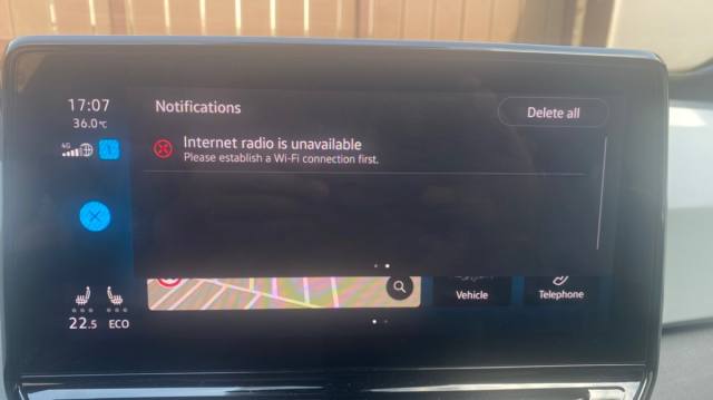

notificarea cum ca nu am internet radio, nu am mai vazut-o pana acum
Ce am citit si am concluzionat eu despre acest subiect:
Noi teoretic ar fi trebuit sa primim 3 ani gratis de servicii "We Connect Plus". Iar serviciile "We Connect Plus" teoretic INCLUD trafic de date pentru Internet Radio. Dar dintr-un bug de implementare (intentionat sau nu...), traficul de Internet Radio n-a fost activat ca parte din abonamentul "We Connect Plus" pentru cei cu ID.3 / ID.4
Am citit pe undeva, nu mai retin pe unde, ca acum cu versiunea 2.4 sau 3.0 s-a corectat acest "bug".

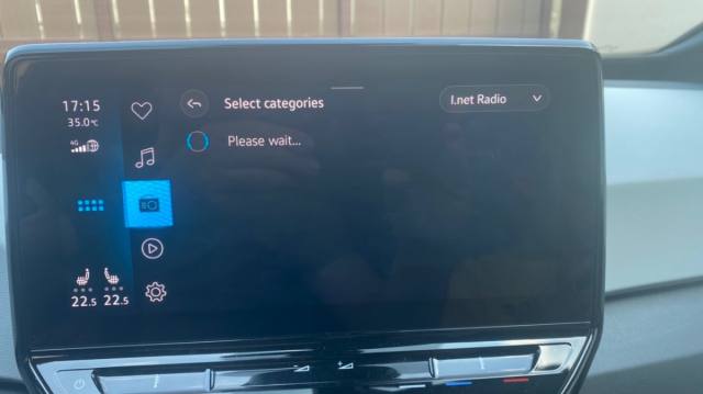

In schimb s-a sters intervalul de service, acum arata cam 635 zile, dar nu e ok.
Am mesajul cu internet radio, car2x functioneaza. Internet radio nu functioneaza.
Car2x-ul ala face ceva pana la urma, sau e degeaba?
