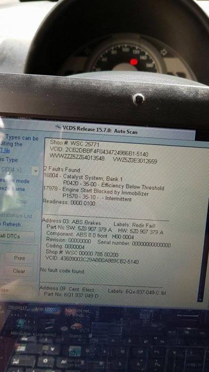

Sal... Am și eu câteva erori la un passat b7 benzina... ma poate ajuta și pe ma cineva...
Scan: 01 03 08 09 15 16 17 19 25 37 42 44 46 4F 52 53 56 61 62 72
VIN: WVWZZZ3CZCP027853
01-Engine -- Status: Malfunction 0010
04-Steering Angle -- Status: OK 0000
08-Auto HVAC -- Status: OK 0000
09-Cent. Elect. -- Status: Malfunction 0010
15-Airbags -- Status: OK 0000
19-CAN Gateway -- Status: Malfunction 0010
37-Navigation -- Status: Not registered 0011
4F-Centr. Electr. II -- Status: OK 0000
53-Parking Brake -- Status: OK 0000
56-Radio -- Status: OK 0000
61-Battery Regul. -- Status: OK 0000

Salut. Ieri m-am trezit cu martorul check engine clipind si tremura toata masina. Passat 1.6 2002 ALZ
Pe tester da cam asa
Address 01: Engine        Labels: Redir Fail!
   Part No: 3B0 906 018 L
   Component: 1,6LR4/2VSIMOS3 00HS0002
   Coding: 06031
   Shop #: WSC 00028
   VCID: 29591B2FD30CF956E3D-5000
   WVWZZZ3BZ2P306966     VWZ7Z0A4748587
4 Faults Found:
17526 - Oxygen (Lambda) Sensor Heating; B1 S2
            P1118 - 35-00 - Open Circuit
16955 - Brake Switch (F)
            P0571 - 35-00 - Implausible Signal
Primele 2 erau si inainte.
16555 - Fuel Trim; Bank 1
            P0171 - 35-10 - System Too Lean - Intermittent
Readiness: 0000 0001
Control Module Part Number: 3B0 906 018 L
