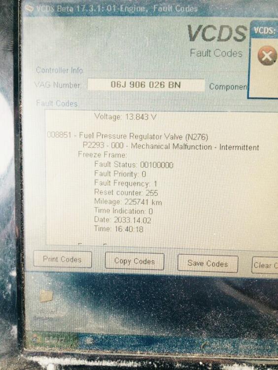

Am si eu un 2010 VW Touran 1.4 TSI EcoFuel CNG, la ultima vizita la service am gasit urmatoarele erori:
- 013136 - Fuel Trim (Nat. Gas Operation ) Range 1
P3350 - 000 - too Lean - MIL ON
- 013138 Fuel Trim  (Nat. Gas Operation ) Range 2
P3352 - 00 - Too Lean - Intermittent
- 000262 - Mainfold / Barometric Pressure Sensor (G71) / (F96)
P0106 - 000 - Implausible Signal - Intermittent
Acuma problema se pune in felul urmator.
Masina dimineata porneste la a doua cheie, deoarece ea porneste pe Benzina si trece automat pe CNG gaz, insa dupa ce intra gazul mi se opreste motorul!
Daca tin masina turata sau din mers atunci cand intra gazul numai moare motorul!
Am fost la VW service autorizatii de VW Germania nici un service nu vrea sa o bage deoare au scuza ca nu au documentatie pentru CNG.
La service de cartier am fost la 3 iara parerile sunt impartite ca ar fi Sonda Lambda, Injectorul sau furtun Vacum.
Insa am descoperit pe forumuri in Germania ca a fi Pompa de Inalta Presiune.
Tin sa precizez ca masina porneste pe Benzina trece pe Gaz dar acuma consuma si Bezina iar inainte nu consuma decat la pornire!
Astept o parere sau o rezolvare!

6 Faults Found
10085 - Neutral Gear Sensor
          P15A1 00 [096] - Implausible Signal
          Intermittent - Not Confirmed - Tested Since Memory Clear
             Freeze Frame:
                    Fault Status: 00000001
                    Fault Priority: 2
                    Fault Frequency: 2
                    Mileage: 141100 km
                    Date: 2064.14.21
                    Time: 12:13:23
10086 - Neutral Gear Sensor
             Freeze Frame:
                    Fault Priority: 2
                    Fault Frequency: 1
                    Mileage: 141100 km
                    Date: 2064.14.21
                    Time: 12:13:23
10090 - Neutral Gear Sensor
          P15A1 00 [104] - Implausible Signal
          Intermittent - Confirmed - Tested Since Memory Clear
             Freeze Frame:
                    Fault Priority: 2
                    Fault Frequency: 57
                    Mileage: 140518 km
                    Date: 2063.14.30
                    Time: 12:28:25
10088 - Neutral Gear Sensor
          P15A1 00 [040] - Implausible Signal
             Freeze Frame:
                    Fault Priority: 2
                    Fault Frequency: 254
                    Mileage: 140053 km
                    Date: 2063.14.27
                    Time: 14:15:16
10089 - Neutral Gear Sensor
             Freeze Frame:
                    Fault Priority: 2
                    Fault Frequency: 63
                    Mileage: 140515 km
                    Date: 2063.14.30
                    Time: 12:22:21
18118 - Unknown Error Code
          P30C0 00 [032] - -
             Freeze Frame:
                    Fault Priority: 2
                    Fault Frequency: 63
                    Mileage: 140515 km
                    Date: 2063.14.30
                    Time: 12:22:21

am uitat sa scriu ca erorile sau sters, dar tot  nu functioneaza......a ramas doar eroarea can gateway si cea de la nav
On 7/10/2017 at 10:55 AM, dionutzu said:
Bateria este oe. Dar nu am fost atent daca este inregistrata sau nu. Masina este sh si nu stiu daca este cea cu care a fost echipata sau a mai fost schimbata pe parcurs. Multumesc.
Salutare. Am rezolvat problema. Se pare ca bateria nu era inregistrata in BEM.
Multumesc pentru ajutor.
dupa 10km de la ramanerea check`ului aprins...aseara la pornire s`a stins
pana acum nu a mai aparut problema la pornire..imi e un pic frica sa o las in soare :))
