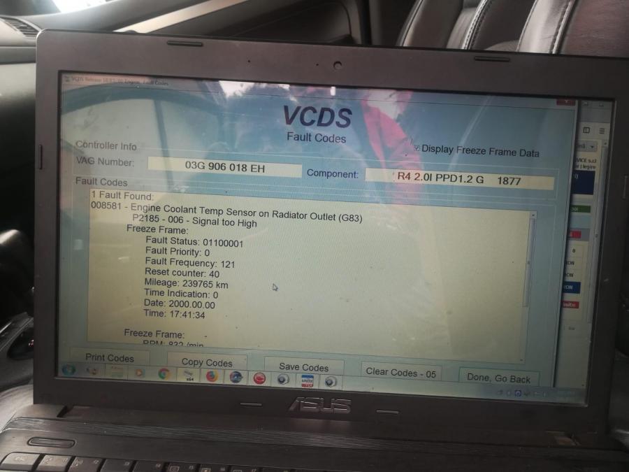

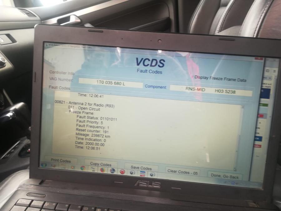

Ma poate ajuta si pe mine cineva cu o rezolvare pentru un VW Touran care a dat urmatoarele erori pe tester?
Ma puteti ajuta cu ceva sfaturi cum as putea sa rezolv aceste erori si cat de grave sunt?
VAG Number: 03G 906 018 EH
Component: R4 2.0L PPD1.2G 1877
1 Fault Found:
008581 - Engine Coolant Temp Sensor on Radiator Outlet (G83)
    P2185 - 006 - Signal too Hight
    Freeze Frame:
        Fault Status: 01100001
        Fault Priority: 0
        Fault Frequency: 121
        Reset counter: 40
        Mileage: 239765 km
        Time indication: 0
        Date: 2000.00.00
        Time: 17:41:34
VAG Number: 1T0 035 680 L
Component: RNS-MID H03 5238
00821 - Antenna 2 for Radio (R93)
    011 - Open Circuit
    Freeze Frame:
        Fault Status: 01101011
        Fault Priority: 5
        Fault Frequency: 1
        Reset counter: 191
        Mileage:239872 km
        Time indication: 0
        Date: 2000.00.00
        Time: 12:06:51
1 Fault Found:
    Freeze Frame:
        Fault Priority: 0
        Reset counter: 40
        Mileage: 239765 km
        Time indication: 0
        Date: 2000.00.00
        Time: 17:41:34
    011 - Open Circuit
    Freeze Frame:
        Fault Priority: 5
        Fault Frequency: 1
        Reset counter: 191
        Mileage:239872 km
        Time indication: 0
        Date: 2000.00.00
        Time: 12:06:51
1. ai schimbat senzorul ? daca nu, verifica intai cablajul pe langa conector, daca e ok, schimba senzorul intai.
2. verifica mufa antenei 2, daca e conectata la RNS
