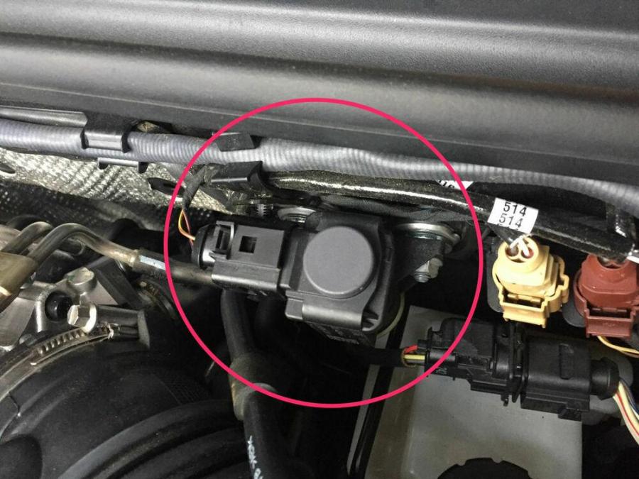

Referitor la zgomotele ( "clank"urile pe retrogradari ) la DQ500 am citit/gasit ceva informatii pe MotorTalk.de, si va transpun cateva din posturile de acolo ( poate unii dintre voi mai cu seama in tehnica, sa ne concluzioneze daca vorbesc prostii, sau solutiile gasite sunt viabile? )
"The DSG is an automated manual transmission which many still do not know or understand it is not comparable to the classic automatic converter. Noises are normal, as normal manual gearboxes, gears and switching sleeves are installed, which are shifted back and forth to switch, except that they are automatic. The clacking is normal, the gangsters and as it is electro-hydraulically controlled and is not a shift lever as in the manual transmission, is it rough as if you turn down at 50km / h it gets louder and louder because the synchronization takes more time than the switching process takes but the mechatronics says driver's wish 2nd gear is therefore also switched and there are noises"
" Hello everybody, I can confirm that from my Tiguan which has also installed the DQ500. When normal roll the DSG switches to the 2nd gear, then I switch back by paddle in the 1st gear I hear that clacking clearly, the 2 part gearbox has already pre-selected the 3 gear and switches when switching back from 3 to 1 gear. The clacking is completely normal and harmless, after all, in the transmission mechanically shift forks are moved in turn move the synchronizer rings. It's not a bug, it's a feature. Here is a video how such a gear works, only the DSG, the gear shift Hydraulic moves but the way it works is the same, you can hear the clack well when a gear is engaged.
 " As already written several times I also suffered from the clacking / beating when downshifting. The cause was a missing rubber buffer on a solenoid valve / assembly (?) Attached to the bulkhead on the driver's side. VW knows the problem and calls the dealer this solution in a problem discussion. I could hardly believe it when I picked up the vehicle: The clunking has completely disappeared!
" Ladedruk control valve" (solenoid valve which is installed in / on the bulkhead) which makes this noise."
" Problem was with me, that where the valve is fixed, a metal bracket was "bent" and the valve noise then finally transferred. If you know it, a trifle. For those where the problem was solved by the valve exchange, it was probably the same because the valve apparently comes including the metal attitude and is completely replaced.
Meaning who has the problem, 3 options : Valve really broken, Rubber buffer missing / defective, Bracket / metal not mounted correctly"
La mine de ex valva are urmatoarele serii/coduri :
VW AG 1K0 906 627 B, CG3 40 11464 A, 12V 35/15 3387

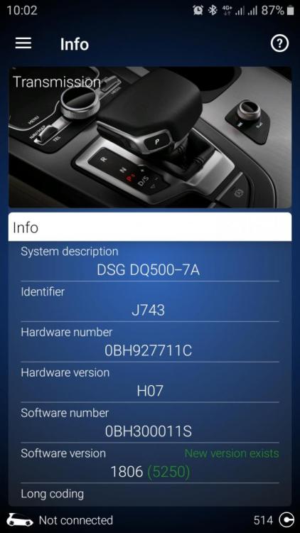

Are cineva informatii despre versiunea aceasta de soft pentru dsg. Am cautat pe google dar nu am gasit nimic.Screenshot_20191113-100226_OBDeleven.thumb.jpg.f6b84a4b955b546d0d405ae89befcc83.jpg
