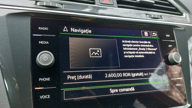

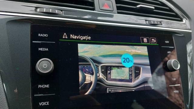

A instalat cineva pachetul de navigatie via volkswagen shop pe un tiguan 2021 ?
daca da, puteti sa-mi spuneti va rog daca prin instalarea acestui serviciu se ofera si functia "Road Sign recognition / Recunoașterea semnelor rutiere " (mai exact cele de viteza) ?
daca ai Front assist va merge.
Salut, se pare ca nu o sa mearga functia aia nici dupa instalarea navigatiei  ..
VW WeConnect a raspuns cam asa:
Thank you for contacting Volkswagen Digital Services.
Please be informed that this specific option regarding traffic limit sign recognition was not selected when the configuration of the car has been done and unfortunately cannot be retrofitted afterwards.
Unfortunately even if the vehicle meets hardware requirements, it is currently not possible to retrofit <traffic limit sign recognition> in your vehicle due to technical reasons.
At this moment, We Upgrade package in your vehicle allows to retrofit the following services:
Navigation
App-Connect
Voice control
Please be aware that we do not have information at this moment if the range of possible services to retrofit will be expanded in the future.

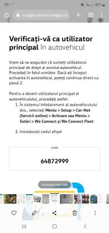

Salutare,nu reușesc și eu sa verific tiguanul,ii fac hotspot și apoi urmez pașii din imagine dar nu reușesc,ma poate ajuta cineva?
