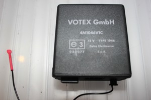

vin si eu cu o intrebare,
ce e asta:
link
am gasit mai multe ipoteze...alarma... controler 1.6... nu inteleg de ce e legat spre volan cu doua fire...
ce e asta:
link
http://www.ebay.de/itm/Audi-ORIGINAL-Steuergeraet-KEYLESS-ENTRY-KEY-LESS-4M1046V1C-VOTEX-/370909397510?nma=true&si=nTO9ph0fxUL2Z7frauEsqLZ0Wtk%253D&orig_cvip=true&rt=nc&_trksid=p2047675.l2557
http://www.golfiv.fr/audio-electronique-embarquee-f9/centralisation-a-distance-t10964-50.html
http://www.golf1.info/forum/index.php?page=Thread&threadID=67518
