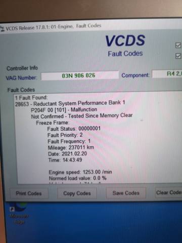

                Address 01: Engine       Labels: 04L-907-309-V2.clb
Control Module Part Number: 04L 906 056 KF    HW: 04L 907 445
  Component and/or Veersion: R4 2.0l TDI   H02 6185
           Software Coding: 0025401C436601080000
            Work Shop Code: WSC 02737 790 50316
              ASAM Dataset: EV_ECM20TDI03004L906056KF 004015 (VN75)
                       ROD: EV_ECM20TDI03004L906056BM_004.rod
                      VCID: 7BF541EEF2E5669C4D-802E
1 Fault Found:
31103 - SCR NOx Catalyst Bank 1
          P20EE 00 [236] - Efficiency too Low
          MIL ON - Intermittent - Confirmed - Tested Since Memory Clear
