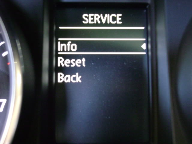

Buna dimineata, am tot cautat , dar nu am gasit nicaieri daca se poate si cum se pune in MFA functia de ,,Service Reset'''. Acum am doar Info si Back.
In Ross-tech spune doar ca : Most North American vehicles with the UDS/ODX protocol instrument clusters have a "Reset" that can be accessed via the MFA,
Sebastyan. G
