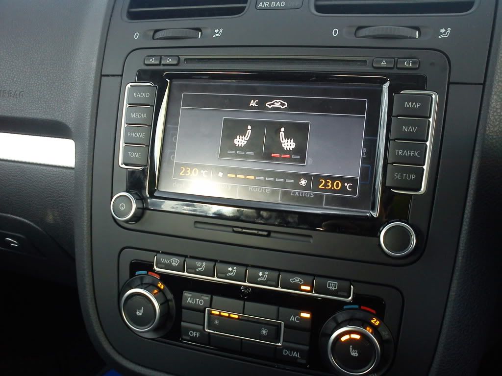

lease note this panel is without auto air reciruclation no letter A next to inverted arrow, i went for this type of unit as it doesnt have auto air circulation so dont need to install air quality sensor and no extra wiring changes required.you could say its a like for like replacement, as my standard unit didnt have the letter A next the air circulation button.
this is a copy of my original unit i had fitted before i changed to the 5k0 907 044 CF
this in my unit installed and working perfect
