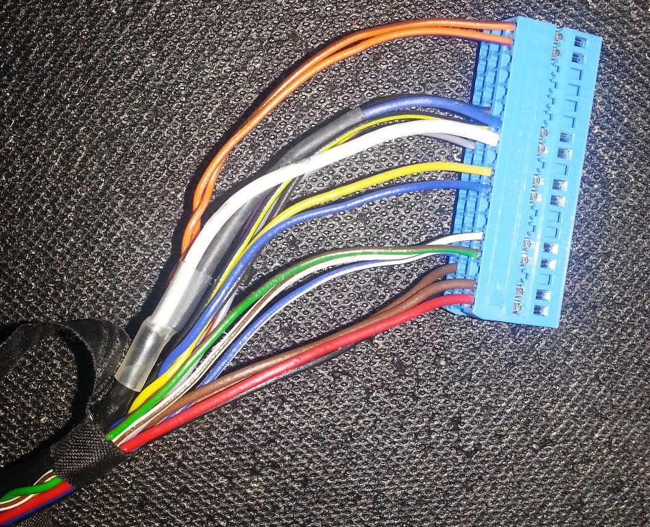

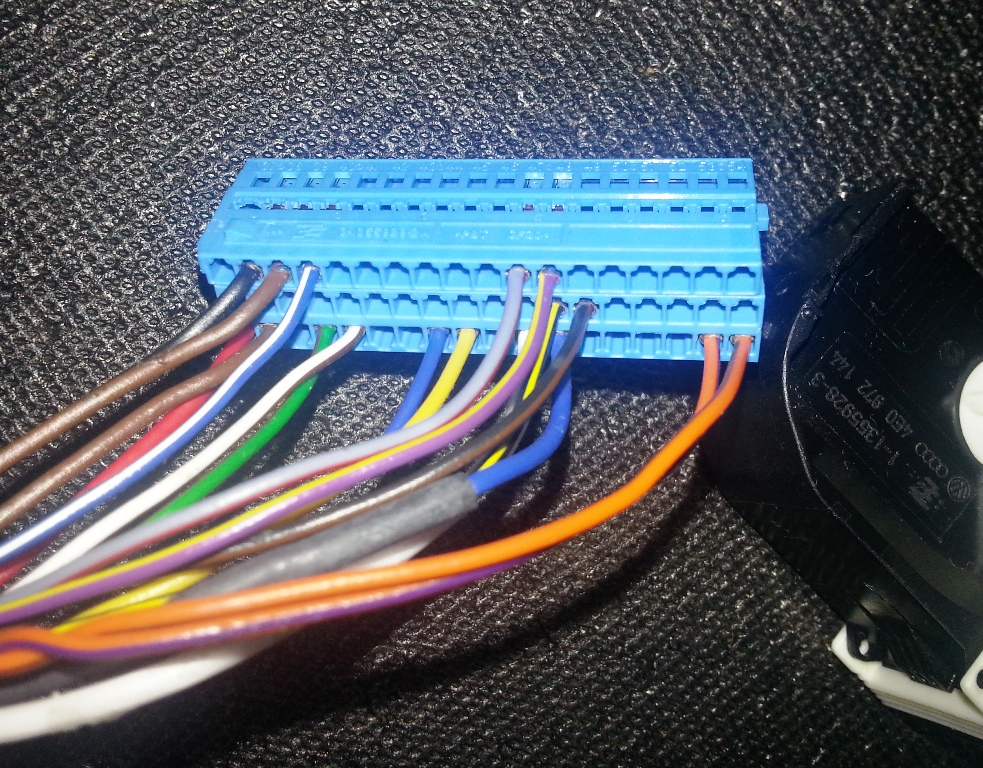

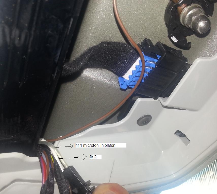

stie cineva care sunt firele de la microfon ?
este mufa cu 54 pini ce intra in centrala telefonica bluetooth .
par a fi pinii 11 si 12 dar daca stie cineva sigur ...

1 V+ to pin 16 (actually pin 15 on harness)
2 V- to pin 12
3 Telephone ON
8 Audio LF Signal out + connected to be connected to pin 12 con 3
9 Audio LF Signal Out – connected to be connected to pin 6 con 3
10 Screening Term 31
11 Mic in +
12 Mic in -
15 K Line
16 Mute
17 CAN Hi to pin 9
18 Can Lo to pin 10
37 Switched positive term for phone charging
39 Term 31 -ve
41 Interface to mob phone Term 30
42 Mic Out +
43 Mic out -
44 Screening Term 31
45 Audio LF Sig input +
46 Audio LF Sig Input -
47 Wakeup lead to phone bracket
49 Serial Tx comms with tele bracket +ve 50 Serial Tx comms with tele bracket -ve
51 Serial Rx comms with tele bracket +ve
52 Serial Rx comms with tele bracket -ve
