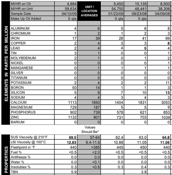

uite ce zice un american posesor de Jetta 1.9 TDI PD 2006
29k-->38k Pentosynth 505.01 5w-40
38k-->49k VW LL III 507.00 5w-30
49k-->54k VW LL III 507.00 5w-30
54k-->59k Mobil 1 Turbo Diesel Truck CJ-4 5w-40
Bypass filter added at 38k, removed at 54k.  Based on these results, I will continue to run M1 TDT and extend OCI to 10k miles.
si o explicatie asupra diferitelor metale din analiza :

FUEL DILUTION = UNBURNED FUEL IN THE OIL MAY SIGNAL FUEL SYSTEM LEAKS OR INCOMPLETE COMBUSTION.
FUEL SOOT = A RESULT IN INCOMPLETE COMBUSTION OR BLOW-BY. HIGH DRAIN LEVELS AMY INDICATES COMBUSTION PROBLEMS OR OVEREXTENDED DRAIN INTERVALS.
VISCOSITY = THE KINEMATIC VISCOSITY DETERMINED AT 40°C AND/OR 100°C IS A MEASURE OF THE FLOW RATE OF AN OIL IN RELATION TO TIME. THIS DATA IS USED TO ASSIGN AN SAE GRADE TO OIL.

Pacat ca nu se vede poza :))
Aici poza de mai sus lipsa.
post-139121-0-16676400-1435432706_thumb.
