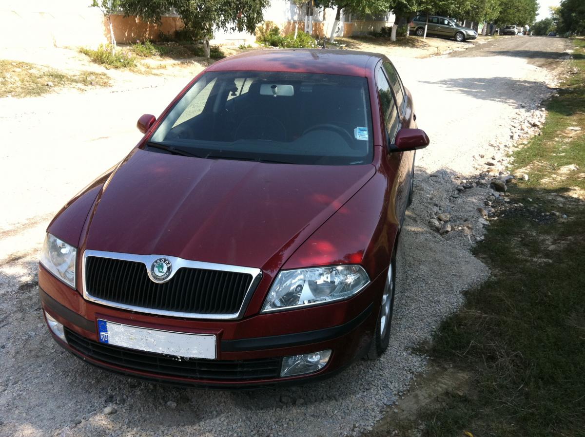

pai e model elegance, fara accident, pilot automat, 6 trepte, 10-12 airbaguri, piele volan si schimbator, 8 boxe, dubluclimatronic,jante aliaj, 4 geamuri electrice,etc...
estetic arata bine....mici zgarieturi...
post-26376-0-23119700-1367928998_thumb.j
Modificat de jonnie
Deci nu are taxa platita?!! min-4500-max 5000euro eu mai mult nu as da
