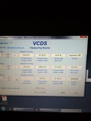

Le-am micsorat dimensiunea: cu motorul oprit 1400979970_1term.jpg.adf96e8b40318a962cf076d11c36abb4.jpg

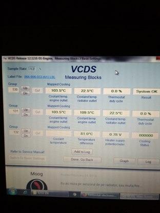

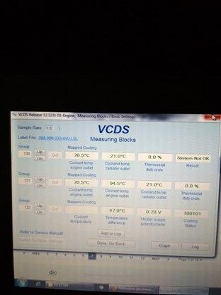

Au pornit ventilatoarele si a aparut eroarea 54650678_3img.jpg.2f2190c80336e4c9b8a6cf48f573d419.jpg

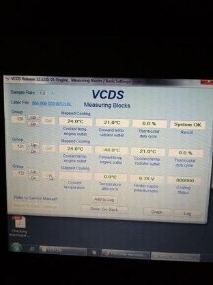

A inceput sa creasca temperatura in radiator 388407755_4img.jpg.d503f7ad0e9cf8fd012959acb7d49e05.jpg

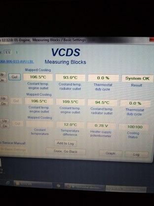

Au pornit ventilatoarele 1500838225_6img.jpg.14b1ce715f221e33c01c5413de2db9ff.jpg
