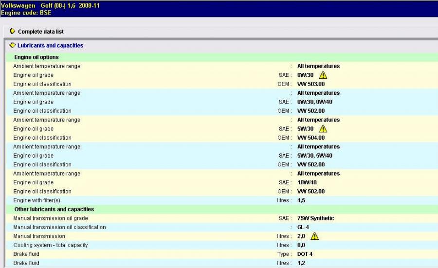

Buna seara, unde pot gasi ce norma are motorul 1.6 mpi, cod BSE, de pe golf 6?
Citat din manual
"Oil capacities:
With oil filter 4.5 l
Engine oil specifications:
→ Booklet38
  Note:   The engine is factory-filled with oil that is determined for long service intervals.
Engine oils conforming to VW standard 500 00, 501 01 or 502 00 can be used furthermore. These oils must be changed every 12 months or 15,000 kilometres. The service interval display must be programmed  "
Iar în Autodata zice aşa:
Alea cu semnul exclamării sunt long life
