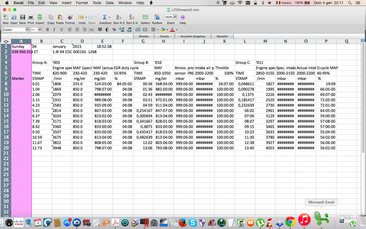

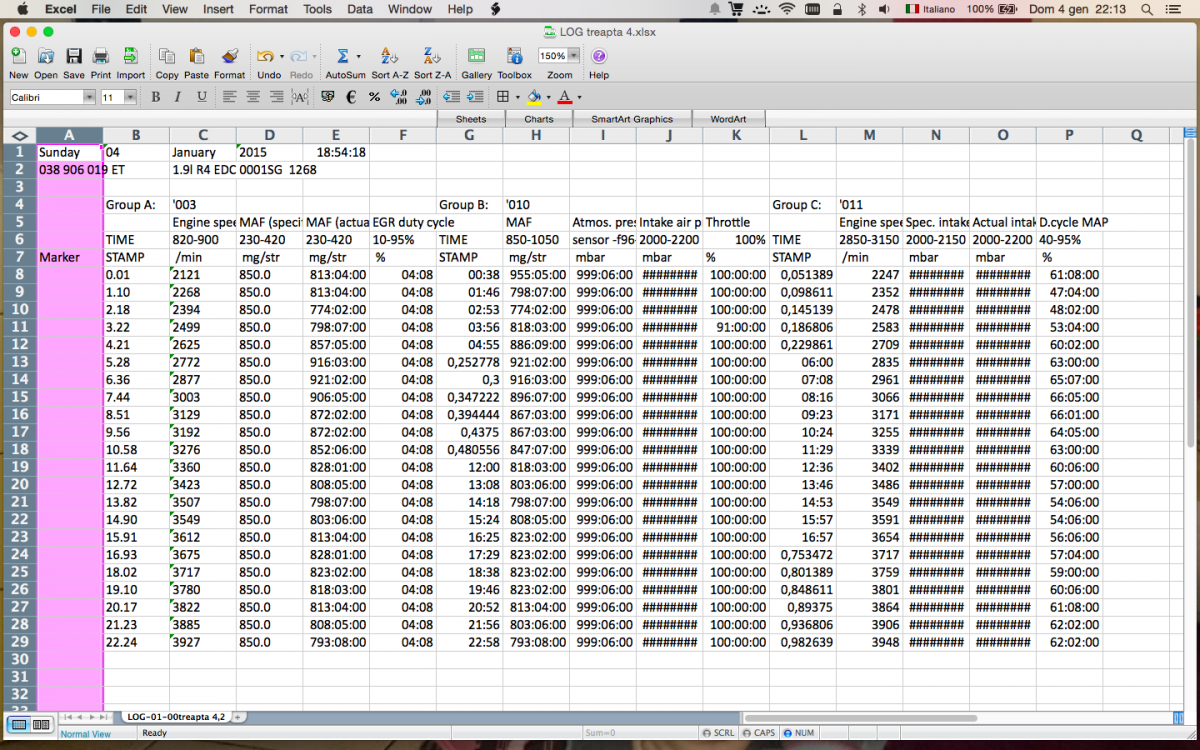

sper sa mearga asa. in format xlsx nu ma lasa sa atasez
  • LOG treapta 4.xlsx
    You aren't permitted to upload this kind of file
post-146038-0-64954300-1420406951_thumb.
post-146038-0-77521800-1420406987_thumb.

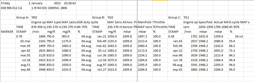

Si cum am promis am atasat si LOGUL SUPRINS IN MOMENTUL CAND TURBO 1.9 TDI ALH A LUAT-O PE ULEI despre care nu ma intereseaza nimik:)) SI APROPO BAIETI DE CE NU A LUAT LIMP DUPA ATATEA SECUNDE DE 94.4% ????
LOG-01-003-010-011 LOG 1.xls
LOG-01-003-010-011 LOG 2.xls
LOG-01-003-BS 003.xls
LOG-01-BS 011.xls
LOG-01-003-010-011alh TURBO PE ULEI.xls
