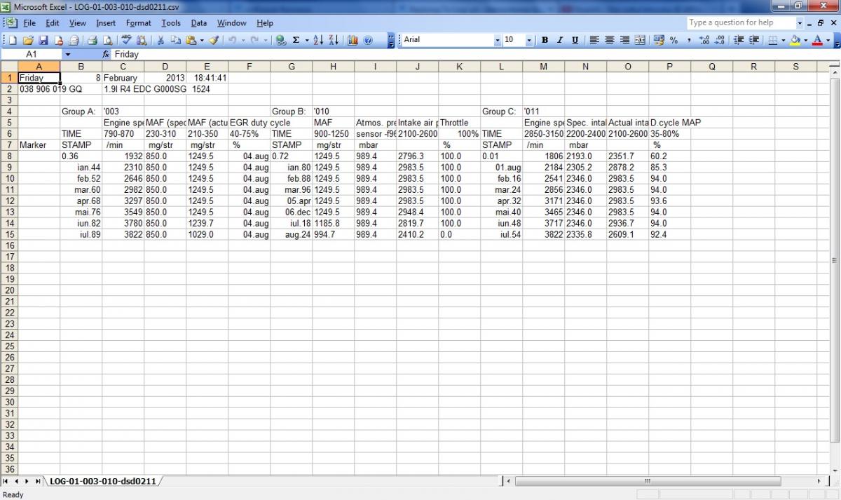

pune un log aranjat ca lumea....asta e amestecat aiurea. Schimba extensia la fisier din .csv in .xls si il poti posta aici.

dragi colegi supun atentiei voastre un log la un passat cod motor avf
toate sunt ok pana la consum
acesta e undeva la 14,15% pe distante pana la 8km
si undeva la 10 11 % la mersul mai mult in oras
mentionez ca acum o saptamana dupa un drum de la constanta la bacau stand la semafor si verificand pe BC timpi consum etc ce am facut de la constanta la consumul instantaneu imi afisa un consum de 1,0 l/h lucru care ma cam pus pe ganduri
de aceea supun atentiei voastre acest log cu ventualele explicatii
multumesc anticipat Monday 4 February 2013 17:14:06 038 906 019 GQ 1.9l R4 EDC 0310SG 1524 Group A: '010 Group B: '011 MAF Atmos. pressure Intake air press. Throttle Engine speed Spec. intake press. Actual intake press. D.cycle MAP TIME 900-1250 sensor -f96- 2100-2600 100% TIME 2850-3150 2200-2400 2100-2600 35-80% Marker STAMP mg/str mbar % STAMP /min mbar % 0.71 289.1 979.2 982.8 11 0.35 861 1152.6 982.8 19.9 1.43 450.8 979.2 1017.9 28.2 1.07 1071 1162.8 994.5 19.9 2.15 504.7 979.2 1146.6 28.6 1.79 1218 1193.4 1088.1 20.7 2.87 480.2 979.2 1240.2 41.6 2.51 1281 1213.8 1193.4 23.9 3.59 681.1 979.2 1719.9 53.7 3.23 1932 1662.6 1380.6 29.1 4.31 583.1 979.2 2059.2 0 3.95 2730 1887 2082.6 66.1 5.03 769.3 979.2 1462.5 59.6 4.67 1995 1142.4 1485.9 40.2 5.75 1249.5 979.2 2340 81.2 5.39 2016 2274.6 1813.5 42.6 6.47 1112.3 979.2 2562.3 85.1 6.11 2583 2346 2772.9 84.1 7.19 1033.9 979.2 2386.8 21.2 6.83 3192 2346 2445.3 76.9 7.91 514.5 979.2 1357.2 14.5 7.55 2940 1030.2 1719.9 49.8 8.63 1078 979.2 1872 100 8.27 2247 2315.4 1392.3 35.1 9.35 1127 979.2 2620.8 100 8.99 2520 2346 2480.4 73.3 10.07 1033.9 979.2 2316.6 100 9.71 2793 2346 2398.5 68.9 10.79 1024.1 979.2 2328.3 100 10.43 3045 2346 2316.6 69.3 11.51 1029 979.2 2351.7 100 11.15 3276 2346 2328.3 70.1 12.23 999.6 979.2 2386.8 100 11.87 3486 2346 2375.1 72.9 12.95 960.4 979.2 2363.4 100 12.59 3696 2346 2375.1 75.3 13.67 921.2 979.2 2293.2 100 13.31 3885 2325.6 2316.6 74.9 14.39 499.8 979.2 1450.8 0 14.03 3528 1050.6 1872 51.4 15.11 490 979.2 1193.4 0 14.75 2289 1009.8 1263.6 43 15.83 431.2 979.2 1123.2 0 15.47 1281 999.6 1146.6 29.5 16.55 465.5 979.2 1099.8 0 16.19 903 1081.2 1111.5 19.9 17.27 450.8 979.2 1088.1 0 16.91 903 1081.2 1099.8 19.9 17.99 343 979.2 1076.4 0 17.63 903 1071 1088.1 19.9 18.71 289.1 979.2 1041.3 0 18.35 882 1081.2 1053 19.9 19.43 235.2 979.2 1017.9 0 19.07 903 1071 1029.6 19.9 20.15 186.2 979.2 1006.2 0 19.79 903 1071 1006.2 19.9 20.87 166.6 979.2 994.5 0 20.51 882 1071 994.5 19.9 21.59 200.9 979.2 982.8 0 21.23 882 1071 982.8 19.9 22.31 259.7 979.2 982.8 0 21.95 882 1071 982.8

imi cer scuze pt postarea logului dar nu a vrut in niciun fel sa se ataseze
vai ce panarama a iesit
imi cer scuze
