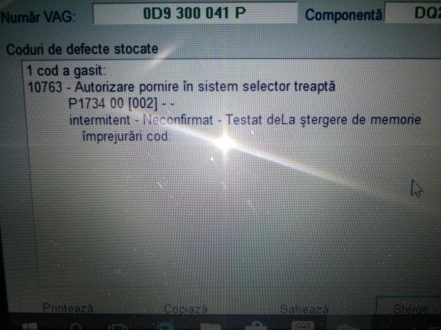

Salutare, La un golf7 dupa o scanare imi da si mie eroarea respectiva
Update....at the advice of my service advisor, he said unplug battery for 15 mins and drive and try again....low and behold, codes all gone.....thanks guys...
