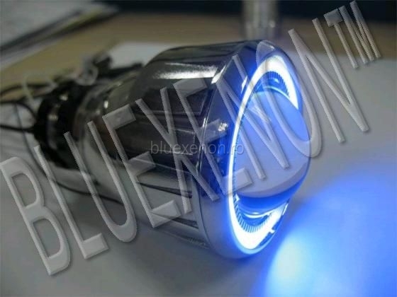

Lupe bixenon angeleyes Pro CANBUS /55W
bluexenon.ro/produse/angeleyes-si-lupe
