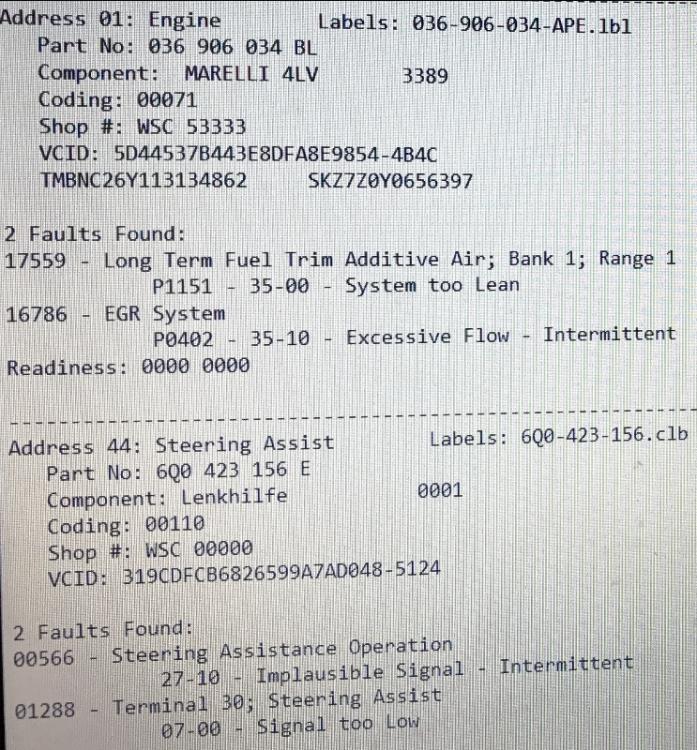

salutare! ajutati ma va rog ca am gasit o caruta de erori.
VCDS Version: Release 15.7.0 Running on Windows 8 x86
Data version: 20150729
www.Ross-Tech.com
Tuesday,04,October,2016,19:29:39:04550
Chassis Type: 6Y (6Y - Skoda Fabia (1996 > 2008))
Scan: 01 02 03 08 09 15 17 19 25 37 44 46 55 56 76
VIN: TMBNC26Y113134862   Mileage: 107020km-66499miles
    Address 01: Engine        Labels: 036-906-034-APE.lbl
   Part No: 036 906 034 BL
   Component:  MARELLI 4LV       3389
   Coding: 00071
   Shop #: WSC 53333
   VCID: 5D445D7B443E8DFA8E9854-4B4C
   TMBNC26Y113134862     SKZ7Z0Y0656397
2 Faults Found:
17559 - Long Term Fuel Trim Additive Air; Bank 1; Range 1
            P1151 - 35-00 - System too Lean
16786 - EGR System
            P0402 - 35-00 - Excessive Flow
Readiness: 0000 0000

sterge-le si vezi care mai apar.
asta a mai ramas
   Coding: 00071
   Shop #: WSC 53333
   VCID: 5D444C7B443E8DFA8E9854-4B4C
2 Faults Found:
16786 - EGR System
Banuiesc ca vorbim despre un motor de 1.4, 16v... ca nu ai scris.
Pentru prima eroare, trebuie sa te apuci de cautat. posibil sa traga aer fals sau sa fie problem cu sistemul de alimentare carburant, evacuare, etc... uite ce zice ross tech, despre cauze si solutii -
Possible Causes
Intake System faulty/leaking
Fuel Pressure, Fuel Pressure Regulator and Fuel Pump faulty
Fuel Injectors faulty/leaking
Exhaust System faulty/leaking
Activated-Charcoal Filter/System faulty/leaking
Secondary Air Injection System faulty/leaking
Lambda/Oxygen Sensor(s) before Catalytic Converter faulty
Lambda/Oxygen Sensor(s) after Catalytic Converter faulty
Possible Solutions
Check Intake System for Leaks
Check Fuel Pressure, Fuel Pressure Regulator and Fuel Pump
Check Fuel Injectors
Check Exhaust System for Leaks
Check Activated-Charcoal Filter/System
Check Secondary Air Injection System
Check Lambda/Oxygen Sensor(s) before Catalytic Converter
Check Lambda/Oxygen Sensor(s) after Catalytic Converter
A doua - EGR-ul - dupa ce o rezolvi pe prima, daca tot apare - poti incerca o curatare a EGR-ului, dar mai mult ca sigur nu o sa ajute - o sa necesite inlocuirea acestuia
