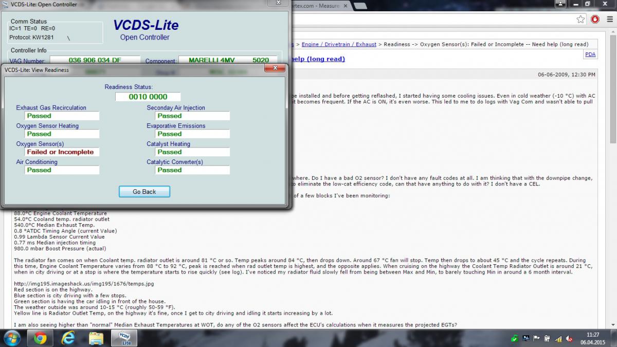

Daca ai vcds, poti testa sa vezi exact daca sondele sunt ok. Te rog sa citesti aici:
http://vwforum.ro/topic/2414-sonda-lambda/page-9
Sau:
http://engine-codes.com/p0138_volkswagen.html
http://engine-codes.com/p0130_volkswagen.html
Succes.
