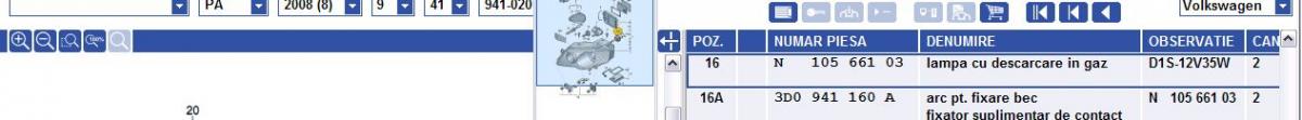

Din Etka rezulta codul N 10566103 / D1S-12V35W (B6 / passat 2007 / xenon ).
