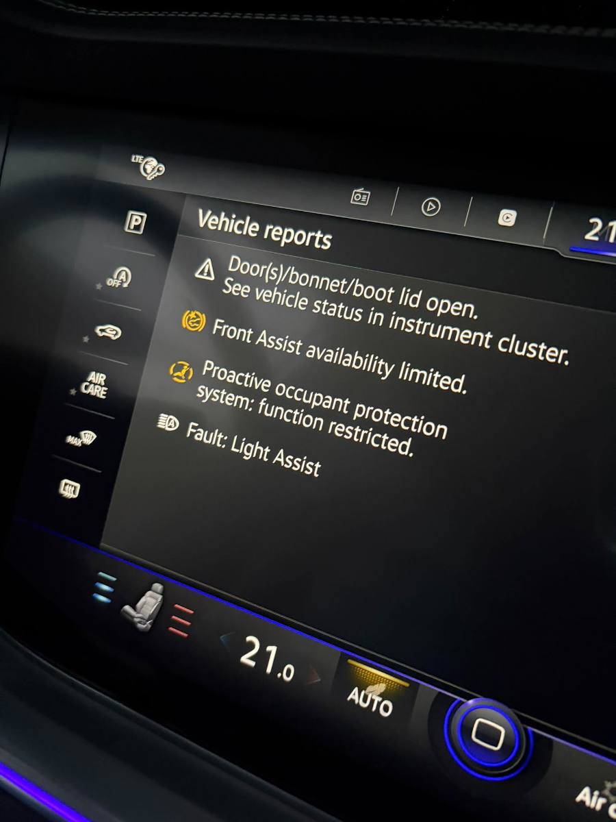

S-a mai lovit cineva de urmatoarea problema: Failure(Front assist): dynamic calibration limit exceeded?

4 Faults Found:
67735 - Databus
          U1123 00 [00001001] - Received Error Message
          [MxB not available]
          Confirmed - Tested Since Memory Clear
             Freeze Frame:
                    Fault Priority: 6
                    Fault Frequency: 3
                    Reset counter: 141
                    Mileage: 190680 km
                    Date: 2026.06.05
                    Time: 19:44:40
                    average_Voltage_terminals: 11.80 V
                    Outside air temperature sensor-Resistance: 0.00 kOhm
                    Outside air temperature sensor-Outside air temperature on CAN: 30.50 °C
                    interior_temperature: 27.00 °C
                    Vehicle speed: 0.00 km/h
                    Terminal activation-Terminal 75 status: On
                    Terminal activation-Terminal 15 status signal: On
                    Terminal activation-Terminal 15 via CAN: On
                    Terminal activation-Term 75: qualification: OFF
67737 - Databus
          [MXB_error-lamp_requested]
             Freeze Frame:
                    Fault Priority: 6
                    Fault Frequency: 1
                    Reset counter: 141
                    Mileage: 190680 km
                    Date: 2026.06.05
                    Time: 21:22:50
                    average_Voltage_terminals: 11.60 V
                    Outside air temperature sensor-Outside air temperature on CAN: 28.50 °C
                    interior_temperature: 28.50 °C
393593 - Positioning Motor for Temperature Flap; Rear Right
          B116A 07 [00001001] - Mechanical Failure
             Freeze Frame:
                    Fault Priority: 5
                    Fault Frequency: 1
                    Reset counter: 141
                    Mileage: 190680 km
                    Date: 2026.06.05
                    Time: 21:22:14
393607 - Motor for Fresh Air / Recirculated Air Flap
          B11AF 07 [00001001] - Mechanical Failure
             Freeze Frame:
                    Fault Priority: 5
                    Fault Frequency: 2
                    Reset counter: 141
                    Mileage: 190680 km
                    Date: 2026.06.05
                    Time: 19:46:33
                    average_Voltage_terminals: 11.70 V
                    interior_temperature: 27.50 °C

1 Fault Found:
221202 - Front Camera for Driver Assist Systems
          C12B3 F0 [00001001] - Dynamic Calibration Limit Exceeded
             Freeze Frame:
                    Fault Priority: 4
                    Fault Frequency: 1
                    Reset counter: 141
                    Mileage: 190680 km
                    Date: 2026.06.05
                    Time: 19:44:37
                    Front camera: status of current initial calibration: Static customer service calibration successful
                    Front camera: details of current initial calibration-Year: 2000
                    Front camera: details of current initial calibration-Month: 0
                    Front camera: details of current initial calibration-Day: 0
                    Front camera: details of current initial calibration-Hours: 0
                    Front camera: details of current initial calibration-Minutes: 0
                    Front camera: details of current initial calibration-Seconds: 0
                    Front camera: details of current initial calibration-Odometer reading: 28617 km
                    Front camera: details of current initial calibration-Status: No calibration relevant malfunction
                    Front camera: details of current initial calibration-Vehicle Identification Number (VIN): WVGZZZCRZJD0
                    Front camera: details of current initial calibration-Focal length: 0
                    Front camera: details of current initial calibration-Calibration marks: line 1: 00111111
                    Front camera: details of current initial calibration-Calibration marks: line 2: 00111111
                    Front camera: details of current initial calibration-Calibration marks: line 3: 00111111
                    Front camera: details of current initial calibration-Calibration marks: line 4: 00111111
                    Front camera: details of current initial calibration-Calibration marks: line 5: 00111111
                    Front camera: details of current initial calibration-Main point of the camera: X coordinate: 640
                    Front camera: details of current initial calibration-Main point of the camera: Y coordinate: 480
                    Front camera: yaw angle (initial calibration)-Front_camera_yaw_angle_initial_calibration: -0.46 °
                    Front camera: pitch angle (initial calibration)-Front_camera_pitch_angle_initial_calibration: -1.48 °
                    Front camera: sway angle (initial calibration)-Front_camera_roll_angle_initial_calibration: -0.18 °
                    Front camera: camera height (initial calibration)-Front_camera_height_initial_calibration: 1540 mm
                    Front camera: details of dynamic calibration:-Year: 2000
                    Front camera: details of dynamic calibration:-Month: 0
                    Front camera: details of dynamic calibration:-Day: 0
                    Front camera: details of dynamic calibration:-Hours: 0
                    Front camera: details of dynamic calibration:-Minutes: 0
                    Front camera: details of dynamic calibration:-Seconds: 0
                    Front camera: details of dynamic calibration:-Odometer reading: 190675 km
                    Front camera: details of dynamic calibration:-Status: No calibration relevant malfunction
                    Front camera: details of dynamic calibration:-Progress: 0 %
                    Indirect distance sensor (LFS) to sensor (LF)-Status: 39175 cm
