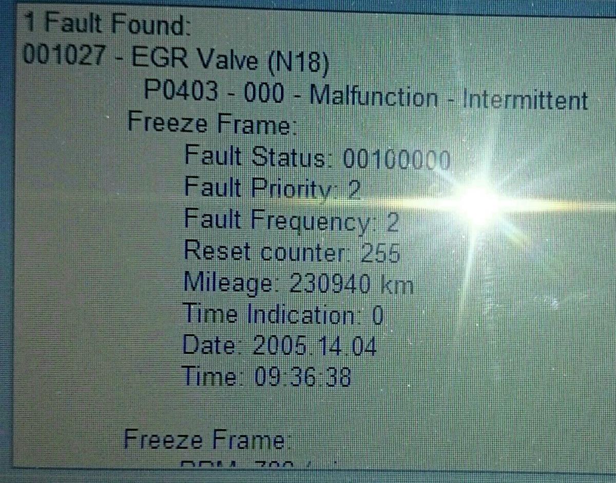

Bună seara,ma puteți ajuta și pe mine cu acest cod de eroare,ce înseamnă?am atașat o poza.
Mulțumesc.

16787/P0403/001027 - Exhaust Gas Recirculation (EGR) Valve (N18): Malfunction
Possible Symptoms
  • Malfunction Indicator Light (MIL) ON
  • Rough Idle Speed and/or Engine stalling
  • Loss of Power
Possible Causes
  • Fuse(s) faulty
  • Wiring and/or Connector(s) from/to Exhaust Gas Recirculation (EGR) Valve (N18) faulty
  • Exhaust Gas Recirculation (EGR) Valve (N18) stuck/faulty
Possible Solutions
  • Check Fuse(s)
  • Check Wiring and/or Connector(s) from/to Exhaust Gas Recirculation (EGR) Valve (N18)
  • Check/Replace Exhaust Gas Recirculation (EGR) Valve (N18)
    • Check Measuring Value Blocks (MVB)
