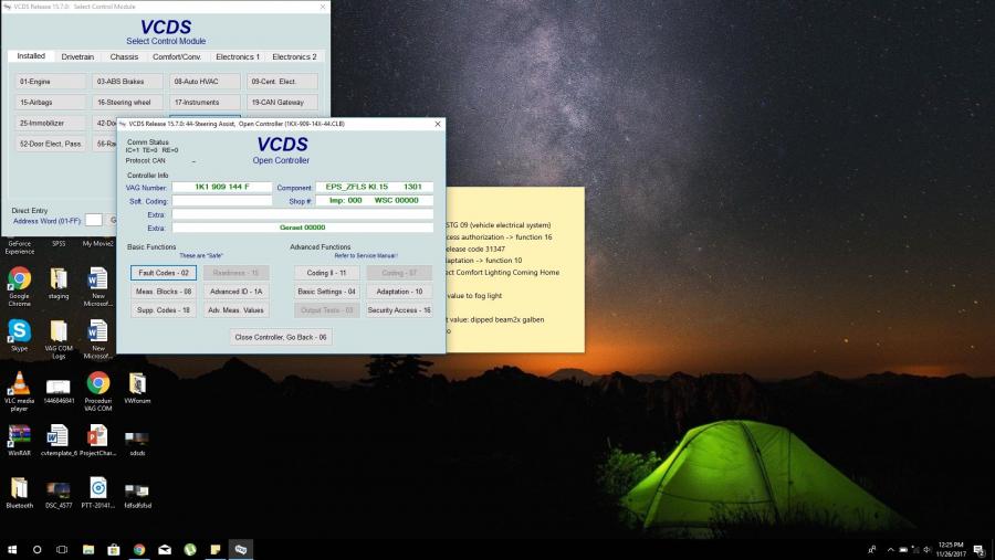

2 hours ago, 1991luk said:
Address 44: Steering Assist        Labels: 1Kx-909-14x-44.clb
   Part No: 1K1 909 144 F
   Component: EPS_ZFLS Kl.15      1301
   Shop #: WSC 00000 000 00000
   VCID: 2E4A1E7B2017B072BDAC28D-807A
3 Faults Found:
02546 - Steering Limit Stop
            005 - No or Incorrect Basic Setting / Adaptation - Intermittent
             Freeze Frame:
                    Mileage: 1280 km
                    Temperature: 16.0°C
                    Voltage: 12.50 V
                    Voltage: 12.30 V
00573 - Steering Torque Sensor (G269)
            008 - Implausible Signal
             Freeze Frame:
             Freeze Frame:

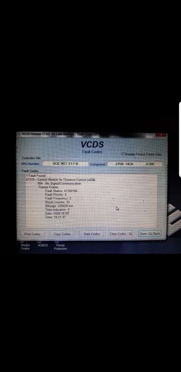

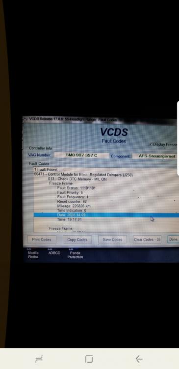

Passat CC 2009.  Am urmatoarele erori pe Lane assist si xenon.
La xenon isi face leveling doar pe lateral sus jos nu.
J250 - verifica sigurantele SC4 si SC 26 din stanga bordului
J428 - verifica siguranta SC19 din stanga bordului
Salutare nu reusesc sa intru in 18 Aux Heatting, (No response from controler) care ar putea fi problema ?
defect, probleme alimentare curent, lipsa acestuia de pe masina.... trebuie sa te apuci de verificat
