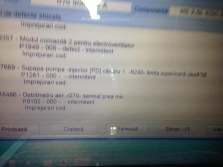

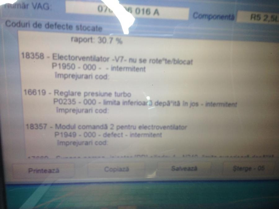

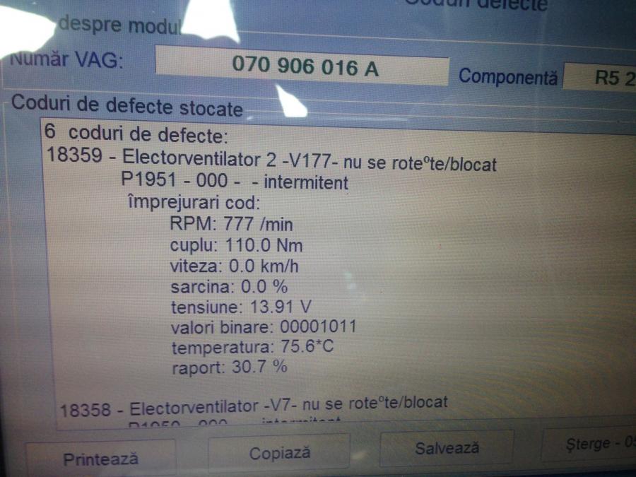

On 18.09.2017 at 5:52 PM, Cristi81 said:
Diagnoza/log in mers/BS turbina si EGR, verificat in grup 007/010 ce valori afiseaza senzorii, cu asta trebuie sa incepi.
In urma diagnozei facute mi a afisat ceva erori legat de debitmetru si turbina.Atasesez pozele cu erorile
Am facut si un autoscan
Sunday,17,September,2017,08:04:15:40973
VCDS -- Windows Based VAG/VAS Emulator
VCDS Version: 12.12.0.0
Data version: 20130910
VIN: WVWZZZ3CZ8P085774   License Plate:
Mileage: 131140km-81486mi   Repair Order:
Chassis Type: 3C (3C0)
Scan: 01 03 08 09 15 16 17 19 25 37 42 44 46 52 53 55 56 62 72
VIN: WVWZZZ3CZ8P085774   Mileage: 131140km/81486miles

Address 01: Engine        Labels: 03G-906-018-BKP.clb
   Part No SW: 03G 906 018 FG    HW: 03G 906 018 FG
   Component: R4 2.0l PPD1.5 G    0907
   Revision: --H55---    Serial number: VWZCZ000000000
   Coding: 0000072
   Shop #: WSC 00028 028 00001
   VCID: 6FED353E7E3D01667D9-803A
3 Faults Found:
004711 - PD Unit Injector: Cylinder 3 (N242)
               P1267 - 006 - Regulation Range Exceeded
             Freeze Frame:
                    Fault Status: 01100001
                    Fault Priority: 0
                    Fault Frequency: 1
                    Reset counter: 40
