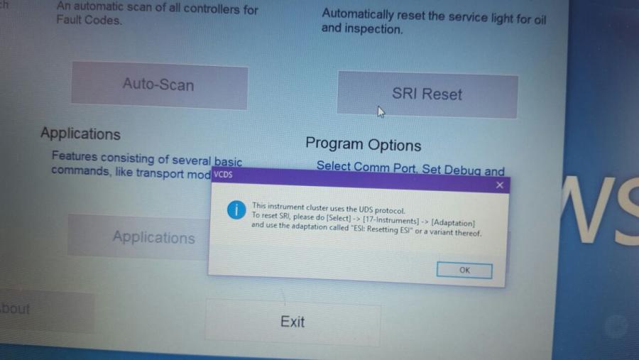

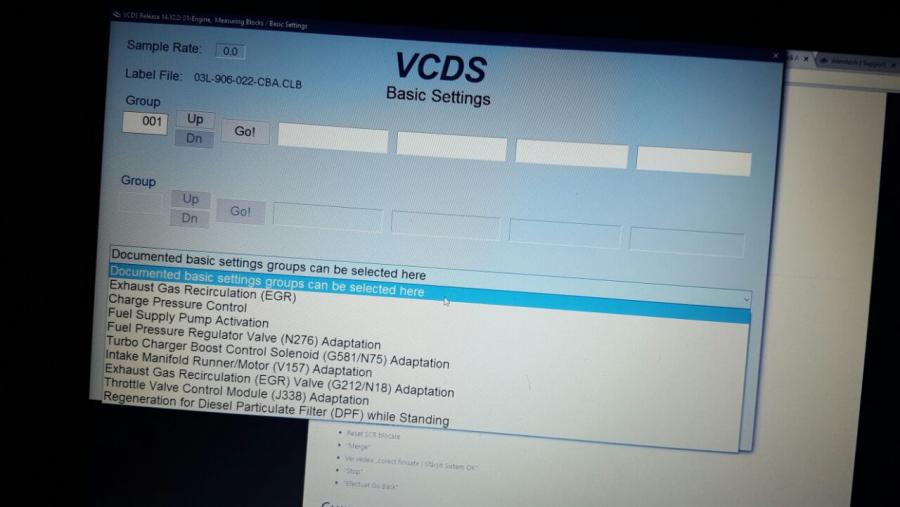

Salut am o problema cu vag com nu pot reseta adblue la un vw cc 2011 2.0 tdi imi apare ca in photo nu stiu ce poate fi ma pute-ti ajuta cu un sfat.
Am intrat si la 17 instrument , adaptation , nu gasesc reset adblue .
Nu cred ca se poate reseta ceva la adblue . Care e problema ?
Am sus calculatorul siu mia sters definitiv eroarea cu adblue si catalizatorul am montatat la loc calculatorul si omul a zis sa dau reset la adblue .

Se poate Catalin. Dar nu din 17- instrumente ci din 01 engine. Vezi intai blocurile de masura nivel scr.
- Ignition ON for 10 minutes, OFF, then drive.
- Check Measuring Values "Status of reduction agent level" / "Status of a reducing agent warning" (if available!)
- Basic settings "Resetting of SCR tank level detection"

 Sau
Prerequisites:
- Engine fully warmed up (above 80’C) and idling
- Transmission in Park/Neutral
- Emergency brake = On
- Doors and hood are closed
- Do not depress any pedals during this procedure, until instructed to do so.
To Reset the AdBlue Level:
- Clear all fault codes(yes, even if there are none present)
- Select 01-Engine]
- Select [Basic Settings-04]
- From the pull down menu choose:
- - - [Resetting of learned values of average quantity adaptation], press [Go!]
- - - - After completion, Press [Stop]
- - - Then [Reset learned values quant. meter. unit and press. contr. Valve], press [Go!]
- Select [Check of SCR efficiency], press [Go!]
- Depress Brake pedal, then depress accelerator pedal, the ECM should take control of the Engine speed.
- This test may take up to 30+ minutes to complete!
- Upon completion, you should see ‘System Okay’, the AdBlue light and the warning message about ‘miles to no start’ will be reset. Verify there are no fault codes.
Done, end…
Nu am gasit unde sa resetez asa apare test1.thumb.jpeg.f162031fae1695ee2dda0d07de0f4d8f.jpeg
Cred ca nu este compatibila diagnoza mea 14.10.0
